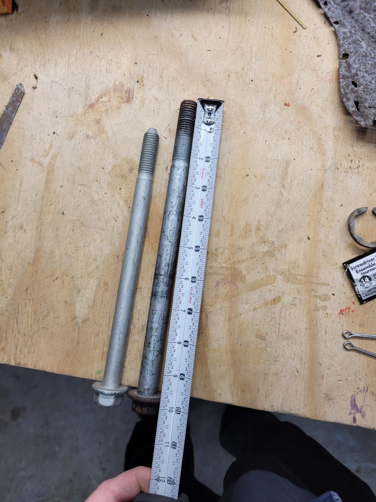

about the only thing I can offer is since the bolt in question is proprietary in nature which means it might be difficult to find
and that it is 14mm in diameter, its quite possible if you can find a bolt in the correct length you could tap out the metric thread for a 9/16th or drill it out a bit and use 5/8 diameter and use a SAE bolt..
