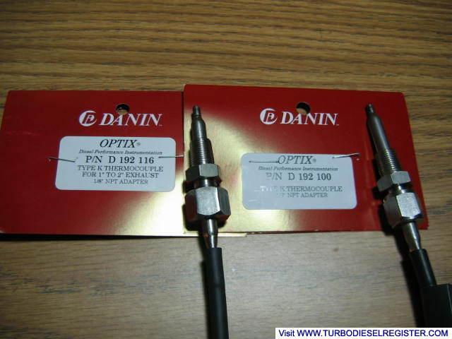

DiPricol short and med EGT probes
The DiPricol probes are not adjustable for length into the threaded hole.
If you install into the exhaust manifold near cylinder 3, then you need the short probe.
If you install into the turbo inlet, then you need the medium probe.
