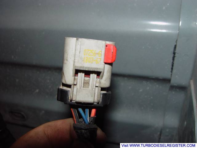

Slide the red tab toward the rear of the truck and push down on the gray tab as you pull the connector off. There are other connectors just like this one aft of the driver's side battery you can practice on to see how they work.
