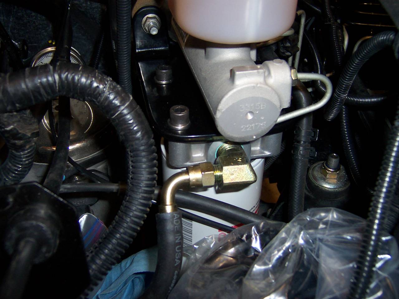

Fuel Filter mod for 2 micron fuel filter
  • Media owner oilrunner
This is a modded fuel filter bracket that bolts dirrectly under my brake master cylinder. It is supported by the 2-existing bolts that secure the brake master cylinder to the rear fire wall. I didn't have room under the air horn and wanted to keep the filter in the engine bay to keep it warm in the winter months.
