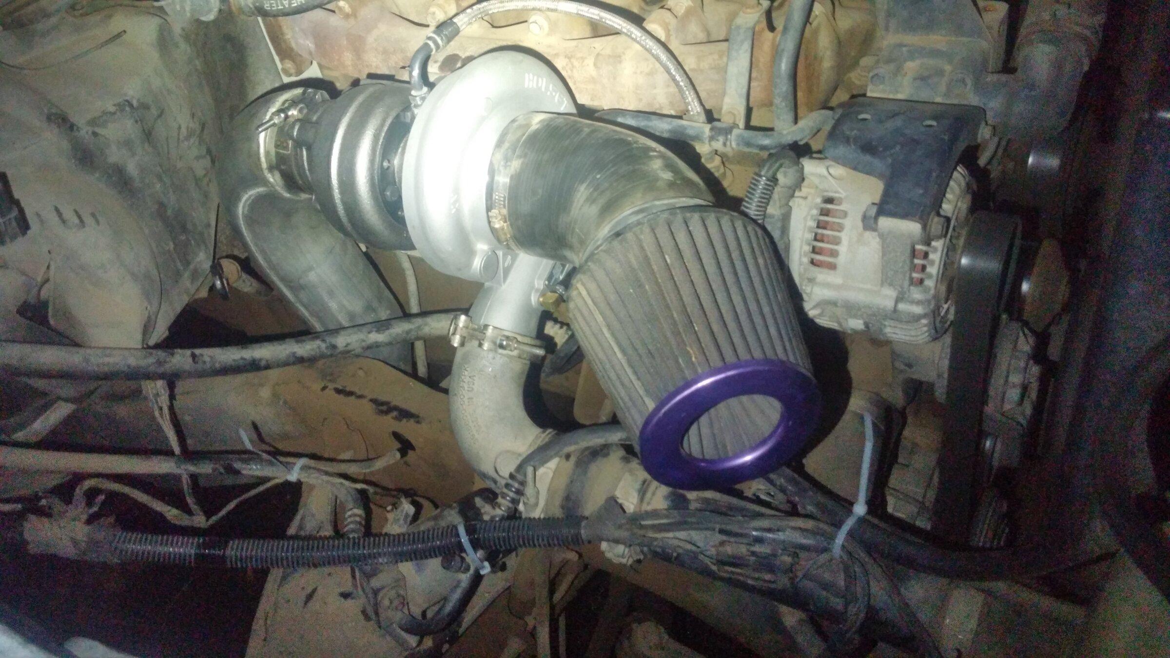

He351w in a first gen
Had to make an oil drain spacer (3/8in aluminum drilled bandsawed and belt sanded) and cut the downpipe to move it back 1.5 inches, but the he351w is in! The ricer air filter is temporary this is not the he351cw. I posted a write up but am not sure if the photos are showing up.
