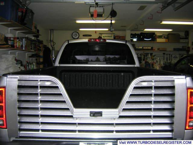

Husky aluminum louvered 5th wheel tailgate
I like this tailgate because its very lightweight and it looks good to me. However, I had to add 4 or 5 washers to each pivot mount to keep it centered (and keep it from moving side to side). I also had to grind my plastic bushings to fit inside the pivot mount OD (it was too small).
