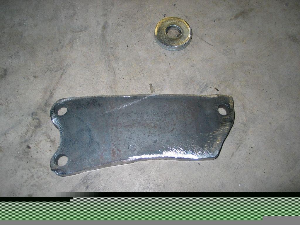

Freeze Plug cover plate cut from 1/2" plate. 2" OD washers were stacked and welded together to form a spacer that is flush with the plate and keeps the plug from moving.
