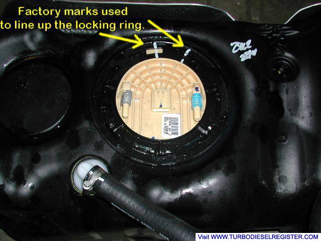

In-Tank-Module markings
This photo shows the in-tank-module installed in the tank. The fuel hose barbs are spaced on either side of the electrical connector and are easier to work with than the earlier (pre '05) trucks. Notice the white marks on the locking ring to indicate the orientation of the ring to re-install
