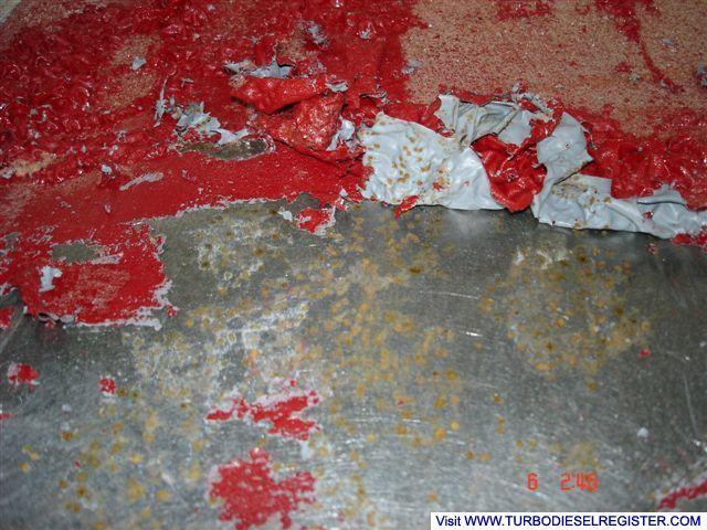

On the roof
This is what I found as soon as the scraper peeled the old paint back. It is only surface rust, but had I not stripped the entire truck, it would have come thru the new paint. I suspect that due to the clear coat failure, this allowed moisture to get to the metal beneath the color and primer coats.
