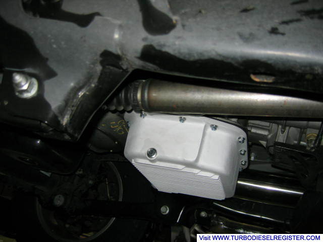

PML "as cast" trans pan (drivers side) w/drain plug
I wanted additional ATF capacity and the ability to drain the fluid w/minimal effort. This modification added 2 additional qts of ATF for a total capacity of 10.25 qts with a filter change and 9.5 qts without a filter change.
I also like that this pan uses the stock overmolded gasket.
