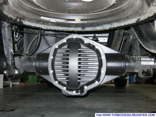

PML black powder coat rear diff cover
I wanted additional gear oil capacity and the ability to drain the fluid w/minimal effort. This modification added 1 additional qt of gear oil for a total capacity of 5.25 qts.
I went with the PML because of the shape, it has clearance with my spare tire when I'm loaded with the 5th wheel. It also uses the stock overmolded gasket.
