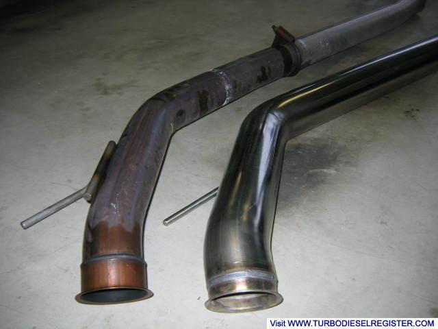

Stock 3.5" downpipe vs. MBRP 4" SS
I wanted an EGT reduction more than a power increase. I thought the 3.5" stock downpipe was a restriction. The color also concerned me that it was getting too hot. I don't have an EGT gauge installed yet...
Use plenty of WD-40 or CRC 556 when re-installing the turbo flange to downpipe clamp and the when installing the SS band clamps.
