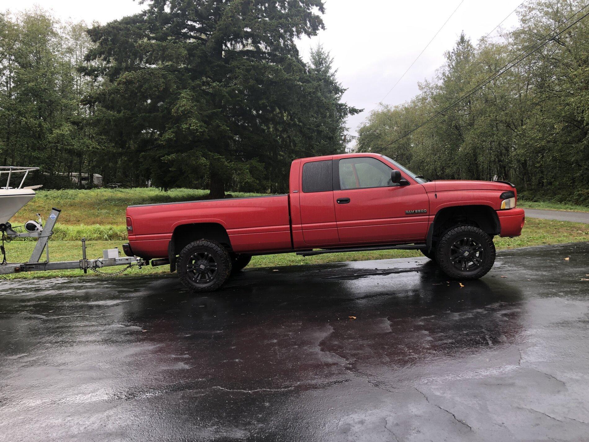

As pictured with tank full truck starts normally. As the tank gets lower it takes longer and longer to fire off. 1/4 tank can turn over up to 5 seconds before firing.
Thoughts???
I think the front is too high, fuel is draining back to the tank:D
Generally a hard start with low fuel is an air leak in the fuel system somewhere. They can be hard to find. Fuel canister or drain valve, return line connection at the rear of the head. I get one once in a while on an overnight low fuel start. I am changing the injectors and connector tubes when they get off back order. With 315K on the injectors that is my first clue. I did install a new drain valve, that seemed to help a lot. Very rare hard start now even low on fuel.
He is parked up hill too. Have him park down hill and see if that helps. It probably will. Is his lift pump good? Any codes?

I thought tank draw/pickup is in the middle. Try parking on level ground. Truck does look higher in front than rear though...
Starts perfectly fine on "level" ground no matter how much fuel in on board.
I actually ran out on a sloped boat launch idling with 1/3 tank. Possibly a bit more steep than pictured.
Truck runs fine se soon as it starts.

Next time, turn the key forward, without starting, let the lift pump cycle, then turn off, and repeat once more. If that eliminates the problem, I’ll be in agreement with @NIsaacs that you have an air leak.
On mine, probably around summer 03, I was having similar issues, my driveway is about 6 or 7°, would happen whether nose or ass in. I found a moist spot on supply line elbow top of tank module (using mirror and flashlight). Using a scotch bright pad I cleaned the elbow revealing a pin hole. BINGO. I installed a Vulcan Draw straw and shortly thereafter a big line kit, walbro pump & filters on frame and eliminated the stock filter installing a GM style fuel pump block off plate on block. Once again BINGO. Not saying this is your problem, but taking a look at this area is free. Easiest to squeeze up and in at driveshaft to look. Also, if you go with draw straw, easiest install is drop the tank. Hope this helps.
A little off topic but still applies. Parking on a hill is not a good practice, never mind fuel issues. Too many things can go wrong, even if it is a "what if". Find a level spot, walking is good for anyone.....
Just turning the key on only runs the lift pump for 3 seconds. Bumping the starter runs it for 27 seconds. So bump the starter once or twice before starting and see if it then starts. A Vulcan draw straw and now hoses. Check of the fuel lines carefully. I had a lot of trouble with the draw valve sealing correctly. What is the fuel pressure running at?
