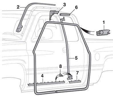

I can't seem to find a part number for the driver (or passenger side) weatherstrip piece that follows up the A pillar and across the top of both doors for my 2001 Quad Cab. Not the actual door seal - the one above it. Part #2 in the pic on this page:
http://www.lmctruck.com/features/de/de9r2.htm

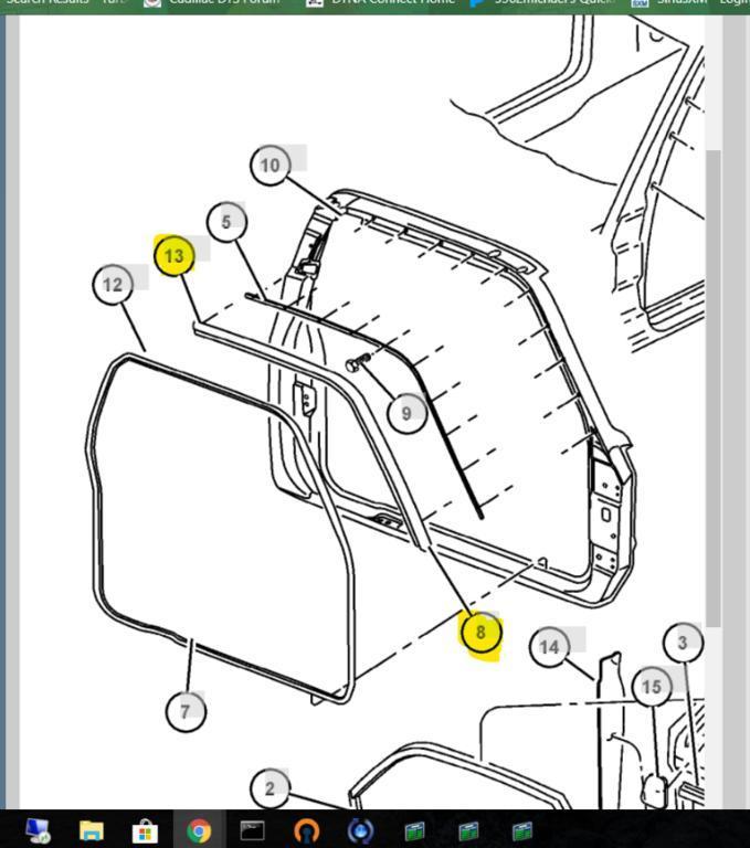

How about "Roof Rail"....Number 12...

Have read your request several times, maybe you are looking for Number 5 in the second pdf above...
I think number 5 (in 2nd image) is the metal mounting rail underneath that attaches with screws.
Therefore I think it's number 13 in the same image... which is also labelled number 8 at the opposite end??!?!?! WT??
The only other issue is that the pic appears to be of an older Club Cab. Mines a later Quad.
So far the closest is # 2 in the LMC image - but without the gobbledy-gook at the end. It's just a simple linear shape.

That is odd that #8 is referenced on one end and #13 is referenced on the other.......
Regardless here are both Part Numbers...
#8 55275394AB MOLDING, DOOR List is $15.75
#13 55275460AD SEAL, BODYSIDE List is $73.35

Looks like those are right and left part numbers but no matter.
Everything appears discontinued.
Geno's advised Dorman.
At least I have good numbers now.
Thanks to everybody for the help. It is very much appreciated.
