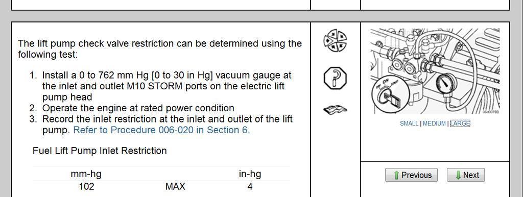

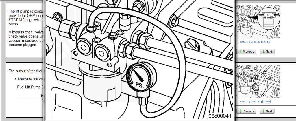

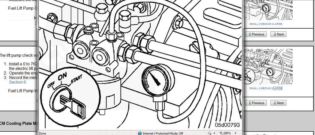

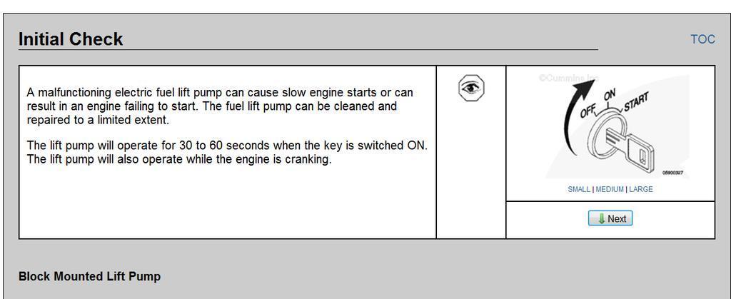

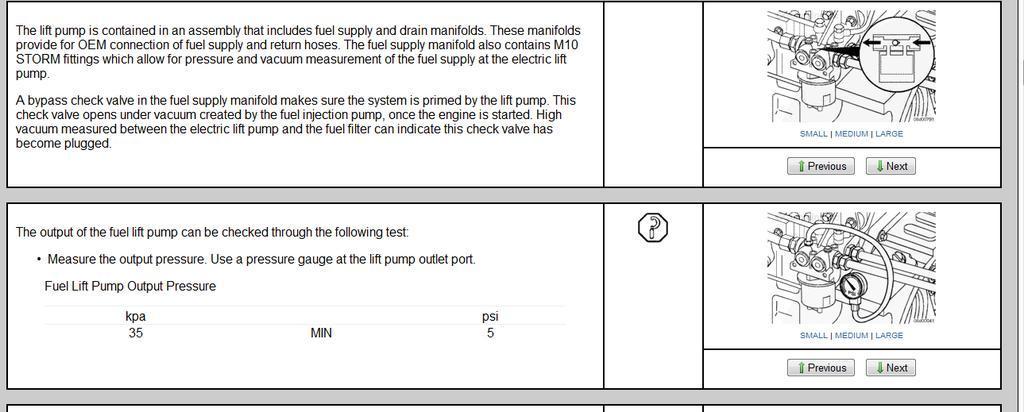

My buddy is almost positive it doesn't run all the time. He says it's loud and that he would be able to hear it - especially when the hood is up and he's under there doing something.
So I'm thinking that if he attached a gauge then it would have to measure both pressure and vacuum.
Just checked this out, that pump only does as stated above. It does not run all of the time unlike the "B" series.
