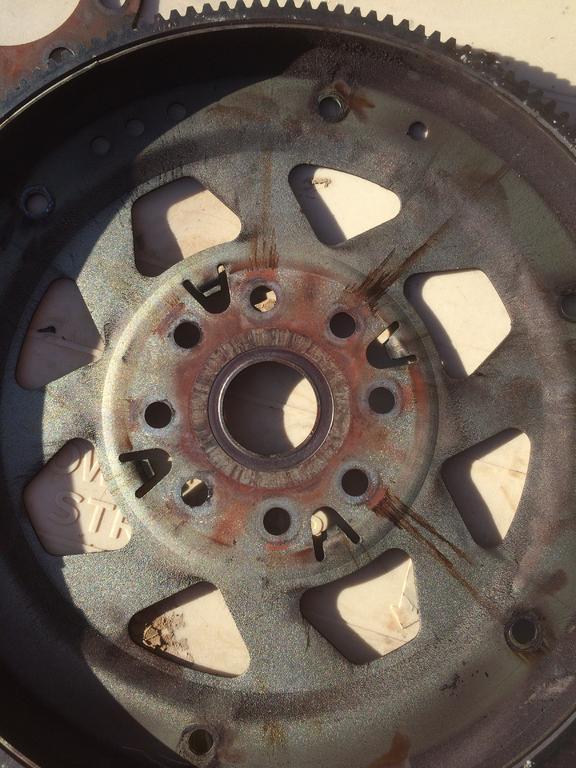

Is this normal TC Noise? I drained the fluid out and there's no metal in it and color seems good and red. I did order an oil test from blackstone and am going to start the engine with trans unhooked when I put the rear main and cam seals in tomorrow or Friday. I went by and spun a few TC's on transmission's and it seemed normal? Something to do with the dog ears hitting? Once I put the truck in gear the noise goes away it's only & idle in park.
This is the flexplate looks like bolts may have been loose on crank but I pulled em off with an impact so I can't say for sure.
