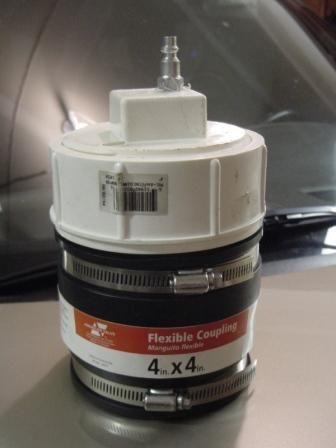

Use a device like this, clamp it to your turbo inlet and start applying air pressure slowly until you find the leak. You should not have to go above 10/11 lbs, since you stated that's when you hear the leak. Jess
Aerosol hairspray works as a sealer for boost hoses too, but is a pain to get them back apart and cleaned up.

Thanks for all the great input I indeed was going to build a tester as JJPage posted I made a similar one when we use to have to blow out the water line from the spring at the farm.
