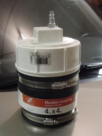

Boost leak likely. Build a "boost leak chuck/device" like this, connect to the turbo and start supplying air, you should find your leak. Be very aware of the danger/injury that can be caused if this blows off the turbo.
