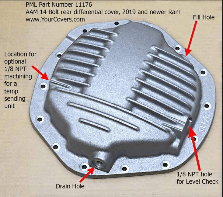

I didn't mean the diff had a dipstick, I was referencing in general for fluids... You fill the diff till oil is level at the bottom of the fill hole. If you have a higher capacity diff cover its going to take more fluid to be at the mfg. recommended level. If the aftermarket diff cover isn't designed with a horizontal fill port/sight glass/or specified oil amount then you'll have to do the math.
It doesn't make sense to design an aftermarket diff cover without a new oil specification amount or a similarly designed mfg. fill port.
The part number is for a 12" AAM but the covers look the same for the 11.5s. Fill, Drain, Level. your cover should have three holes.
Fill quandy will vary also with RAR... A 3:42, 3:73, 4:10 RnP are all different sizes and displace different volumes, so always need to check the actual level on the vehicle. Most published values are just a guide to let you know approximately how much fluid to purchase.
Yes, that's what I'm thinking. It's been so long since I installed the cover I'm not sure if the manufacturer stated a capacity or not. The issue is why the additional .5 qt this time?
The PML cover has been on the truck for over 3 fluid changes now. The first two required 4.5 quarts. The last one done this week took 5 quarts to bring it to "the hole for level check" as in the picture above. My question is should I be concerned about the additional .5 qt ?? Regardless of the amount, I can't see any issue as long as fluid is not above the side hole.

No, cover stayed on as usual. My garage floor is level and this is exactly the same location as previous changes.
Thanks for input. I'm going to drive the truck today, and then remove the side level hole plug and see if it pushes any fluid out.
Not to beat this dead horse, but I pulled the side plug and got no overflow, and the level was still perfect at the hole. The only explanation I've come up with is the fact that when I drained the fluid it was still warm from a 30 minute drive. Normally I drain it cold, but completely.
Maybe since it was warm it caused a more effective draining and hence the extra .5 quart space was opened up. Unless someone can give me a good reason, I think I'm just going to drive it.
In fact even Dodge specs +- 1/4” from the fill hole on the OEM diff cover.
You theory on the extra 1/2 quart is likely correct but even then it makes no difference if it is or not,
In other words, there is no good reason not to just drive it.
