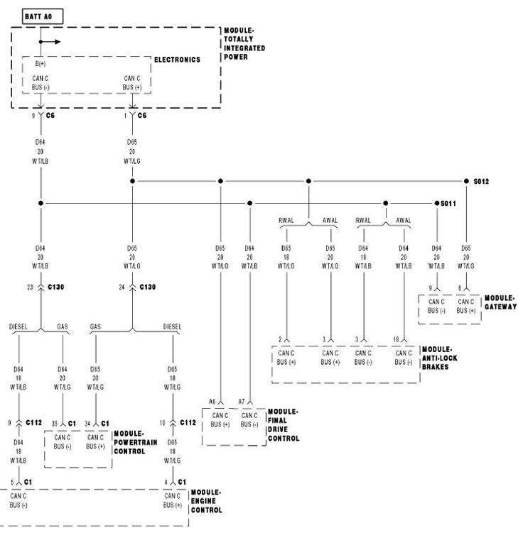

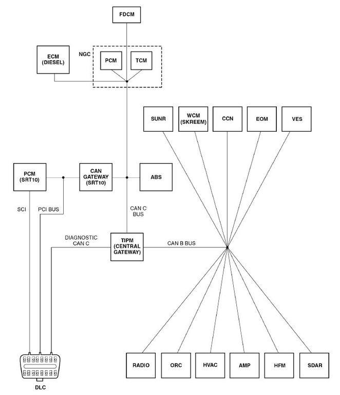

See attached images. The TIPM does connect everything together, and are know to fail if overloaded or shorted.

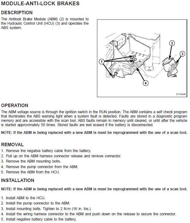

ABS Module - Needs to be programmed according to FSM
Can Bus Overview
Can Bus C
