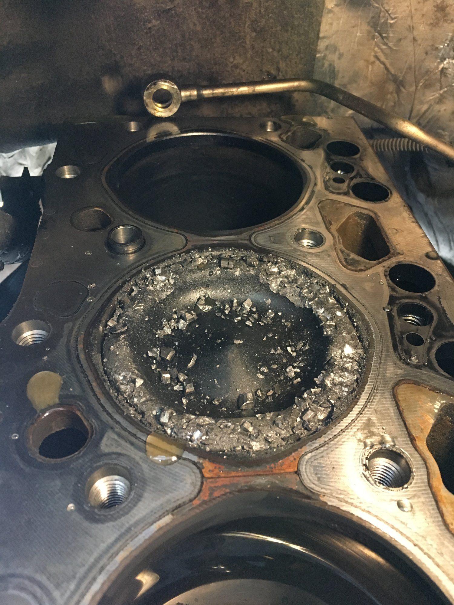

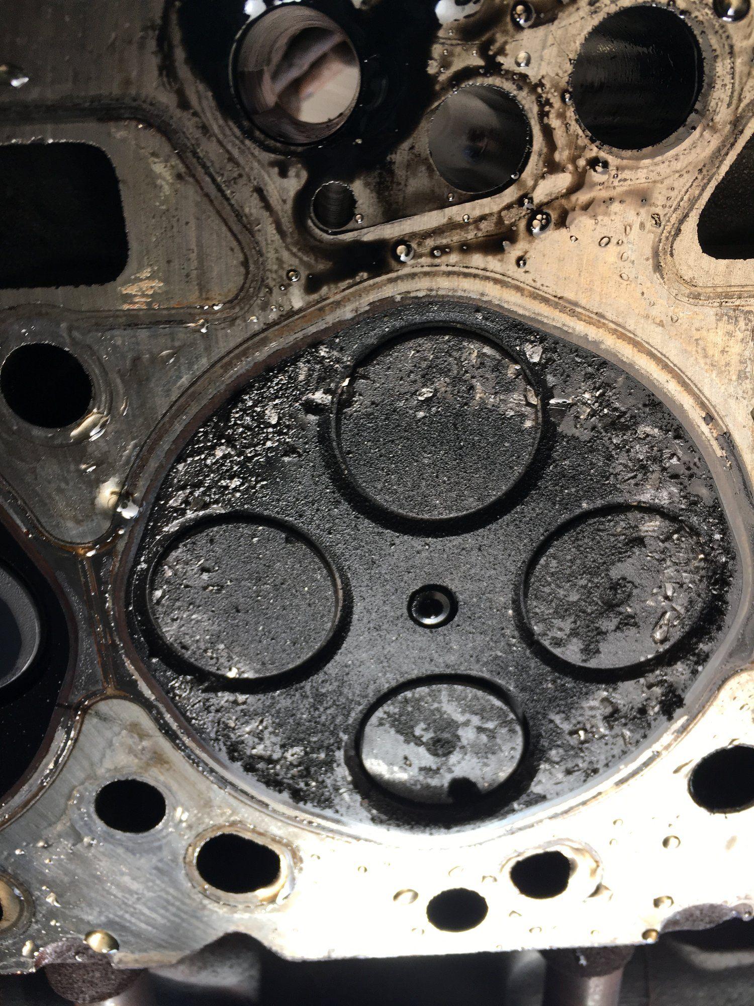

So back on Labor Day weekend we had engine problems, initial diagnosis was a dropped valve. Finally tore it apart today, hole in one of the exhaust valves and a destroyed piston and cylinder. General consensus is #5 injector failed, causing the sudden rise in temperature and destruction. 255K miles on the truck, shame on me no EGT gauge, no excuse. So a couple of questions, the valve seat does not look good, are the seats replaceable? The cylinder wall is scored, does the 5.9 have the replaceable liners? Should I rebuild the whole engine, meaning new rings, bearings, etc based on the mileage?
I have access to a low mileage 6.7 5000 mile engine out of an International rental truck, what’s the feasibility of incorporating it in place of my 5.9? Thanks for your help.

These engines do not have liners but the cylinder is repairable with a repair sleeve installed at a decent machine shop, if the damage is that bad. The head should be able to get a new seat and should be repairable as well.
An engine from other than another Ram won’t work as the block is different, especially 6.7’s.
I think your engine is rebiuldable, and that’s what I would do if it were mine.
Your turbo needs a tear down and inspection as the exhaust side ate anything that came out of the cylinder. You also need to pull the intercooler and clean it and the piping out as debris goes both ways esp. with a bad exhaust valve blowing air back into the cylinder and out the intake valves when the intake valves are open.
EGT will be reading "everything's fine" while a stuck open injector melts everything down and quickly at that. 1/6 burning hot and the other 5 would be cooling the probe off. Prevention is maybe the aftermarket steel pistons they make for the 5.9 could survive a bad injector. Otherwise there really isn't a practical way to save an engine if an injector fails because it happens so fast. Look up Pre-ignition, not detonation, if you really need an idea of how fast things will melt down.
I would test the injector as I see more mechanical damage than melting. How many miles on injectors, better filtration installed? Even tested injectors can have limited miles left in them as I found with my engine rebuild.
As Wayne mentioned it's rebuildable with a sleeve. Add a set of new injectors with the best filtration you can get. You are rebuilding the engine, do I really need to point out the risk of the low bidder rebuilt injectors? The head has impact damage and should be scrapped. Yeah you can clean it up and run it but why put the money in a damaged head for new seat(s) because heads in better shape to start with are not that expensive. You are pulling the engine down to do this so there isn't any reason not to replace all the rings, oil pump, and bearings. Maybe even put in a non-egr aftermarket cam while you are there.

Seats are replaceable and the head can be checked for cracks, first thing to have done before deciding next steps. Looks like it either dropped the valve seat or melted the piston and hot spotted the valve causing it to melt. Doesn't look like much impact damage and the heads are solid, but, check fro cracks first.

BTW Check the pushrods from that hole for being bent.
