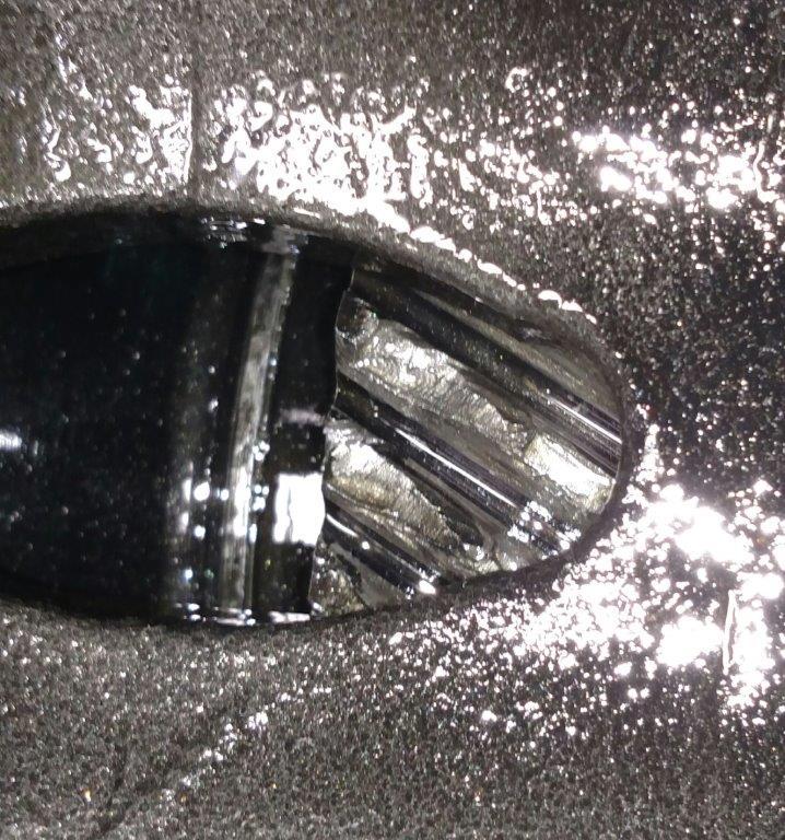

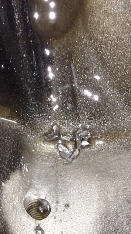

I have 90k now on my 07.5.. I do not abuse it but do tow 20k+ every now and then. I noticed about 80k the rear diff fluid was looking milky or a little silver. It also had some very small pieces of metal in it. We drained the diff. Just today we drained it again and same thing. What might be the problem? Spider gears or ring gear? Your thoughts.
Bearings and ring and pinion if too late. A bad bearing will take out the ring and pinion if run very long or ran loaded.

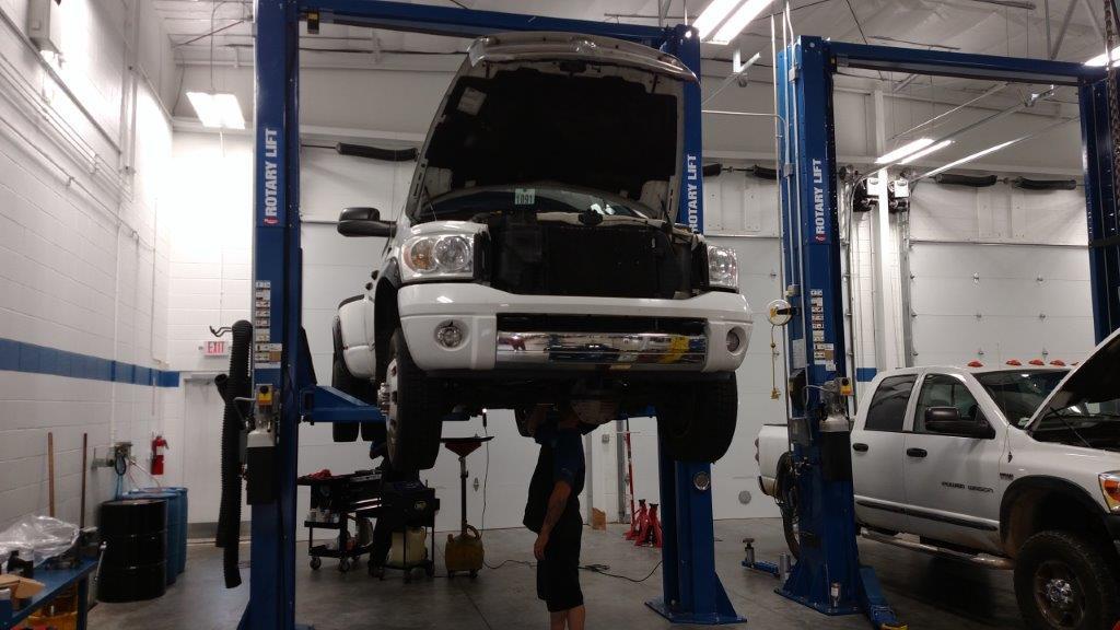

Went into today and had recall fixed. Pulled transmission pan and teck serviced transmission. Picture shows almost no sludge or dirt in pan. That is good after 50k miles of pulling. Teck pulled rear diff. Noticed still more steel chips on magnetic drain plug. Immediately noticed ring gear and pinion are in great shape but spider gears are very bad.
