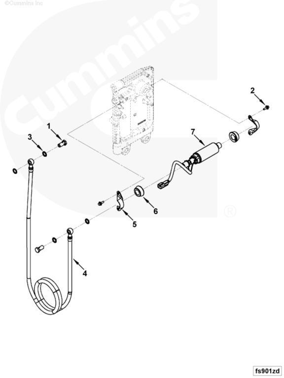

This is where the lift pump is mounted, right by the ECM. Looks like it has a fuel cooled plate behind the ECM and the block.
There is a technical bulletin where Cummins decided mounting them to the engine block was not such a great idea due to the vibration. There is a kit to relocate the lift pump so it may have already been done to yours.

That is the same pump that my customers has. I believe it mounts in 2 rubber isolators. You should be able to hear it especially if you open the doghouse. I believe it will run for a minute at key on, or bump the starter and listen. There is a fuel heater above the filter that those wires go to.
