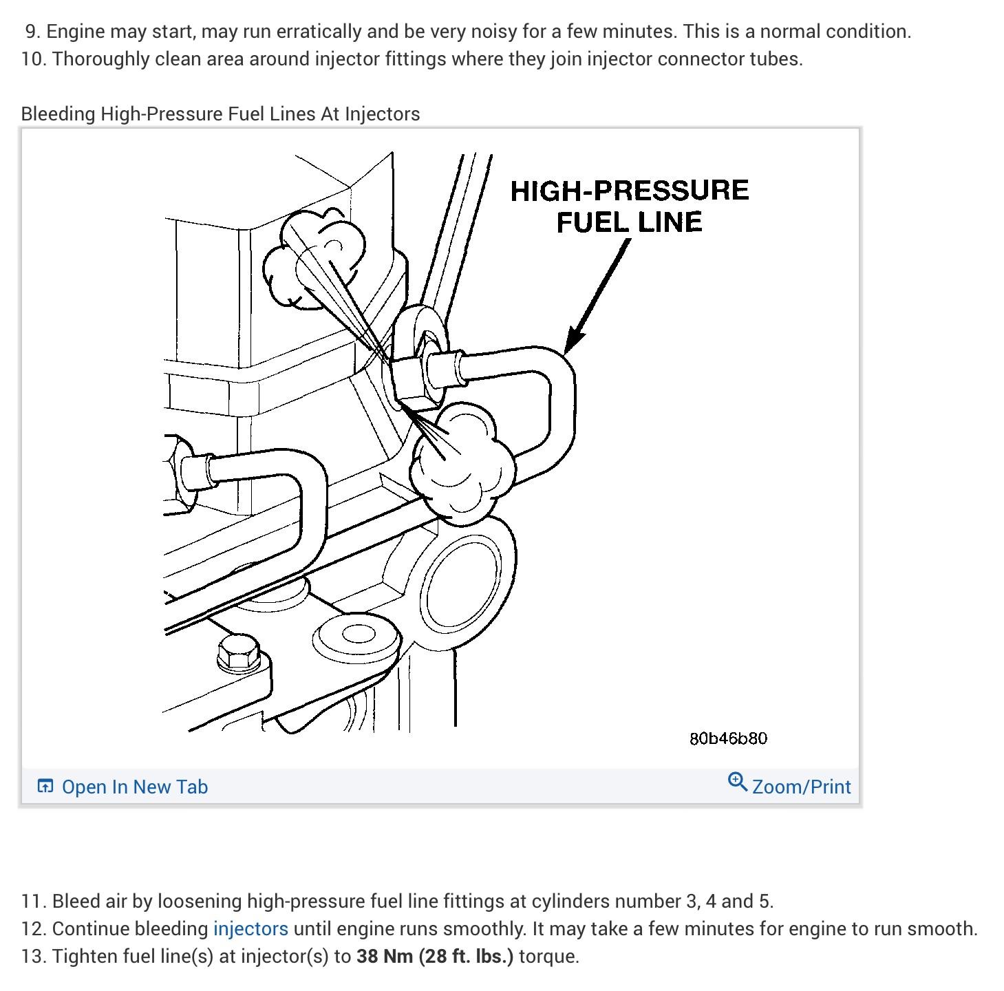

This is the fuel system bleed procedure. Steps 1-7 reference bleeding the low pressure system up to the injection pump.
Step 8 says “Crank the engine for 30 seconds at a time to allow air trapped in the injection pump to vent out the drain manifold.”
