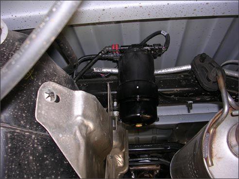

First, this little rascal is hidden underneath the bed of the truck, about mid-way back and just to the left-of-center. Ease of access, let’s call it a 5, and that’s assuming that you don’t mind laying on your back. Here is the photo.

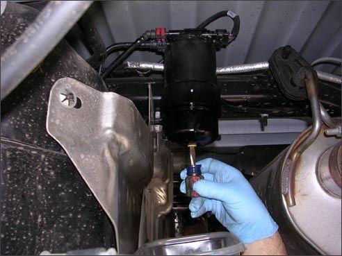

Second, when opened, the tiny yellow drain valve thingee doesn’t drain much fuel. I had hoped it would allow at least 2/3 of the bowl to drain, thus preventing a fuel bath when the bowl was removed. This would not be the case. I drained about two ounces.

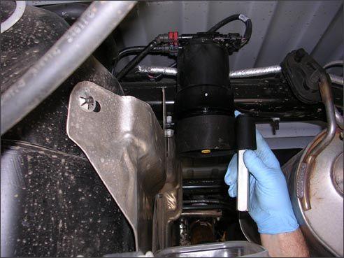

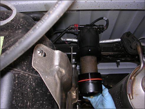

Time to remove the filter bowl: out comes the trusty strap wrench. Wrap it around the bottom of the plastic canister and turn counterclockwise. Place a drain pan (Tupperware-type plastic bowl) under the canister. Turn the strap wrench counterclockwise and be prepared to have diesel fuel run down your arm as you remove the canister.
Insert curse word here __________ .
(Hey don’t say I didn’t warn you.)
