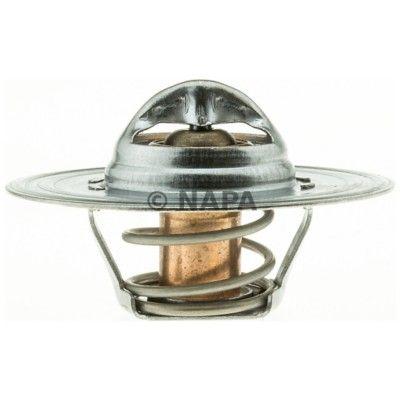

Yeah I may end up replacing the napa THM 291 stat I just bought, but it was cheap enough to give it a go.

The THM291 will not work, note the difference in the two pictures. Note the disk on the bottom of the "real" one, it opens and closes the bypass port. These trucks can run hot towing in hot climates, I would stay with the oem stat. Keep in mind your oem fan clutch might not cycle right with a 190.

But I'm real happy with my $7.84 napa THM 291.. No rubber collar to get swallowed up either. Warmed up to operating temp in less than 2 miles, then held pretty consistently except for the second stop where looks like it dropped to 175 which is warmer than my factory stat ran at.
View attachment 109288 View attachment 109289
I get it now NIsaacs.. Without the disk, the bypass is always open and reduces the effectiveness or capacity of the cooling system. But it may also smooth out the bouncing when unloaded. I wont know if there is a problem until I'm towing in hot weather, which would be a bad time to swap in the cummins stat..
Yes, I think so, it is there for a reason. I just assumed that it would help the temp swings but I have not used one without so I really can't compare. Keep us posted this summer on how it does. My '01 has a complete new cooling system and it will still run hot, towing on a hot day. However, I don't think Dodge built it for an Edge Juice:)

The cummins bypass opening and closing will make it swing worse, but more capacity. The reason my napa stat doesn't swing as much, is that the system is already closer to full capacity (btu's removed) since a open bypass reduces ability to remove btu's. Should be interesting this summer..

I think part of the reason for the t-stat bypass disk is to assist in heater core flow. With the bypass always open, the coolant might just take the easy road and not flow as much through the heater core, especially at low rpm or idle.
Actually, when the thermostat is closed, the bypass port is open.
This is to ensure coolant circulation through the head & prevent hotspots.
Since the heater inlet is fed by the cylinder head outlet, this helps the heater core put out heat quicker.
When the stat is open, the bypass port is closed by the bypass disc/or a tapered seat depending on the generation of truck.
I've lasered the temps with & without a bypass style thermostat on identical back to back hot runs, and there is no difference that I found.
