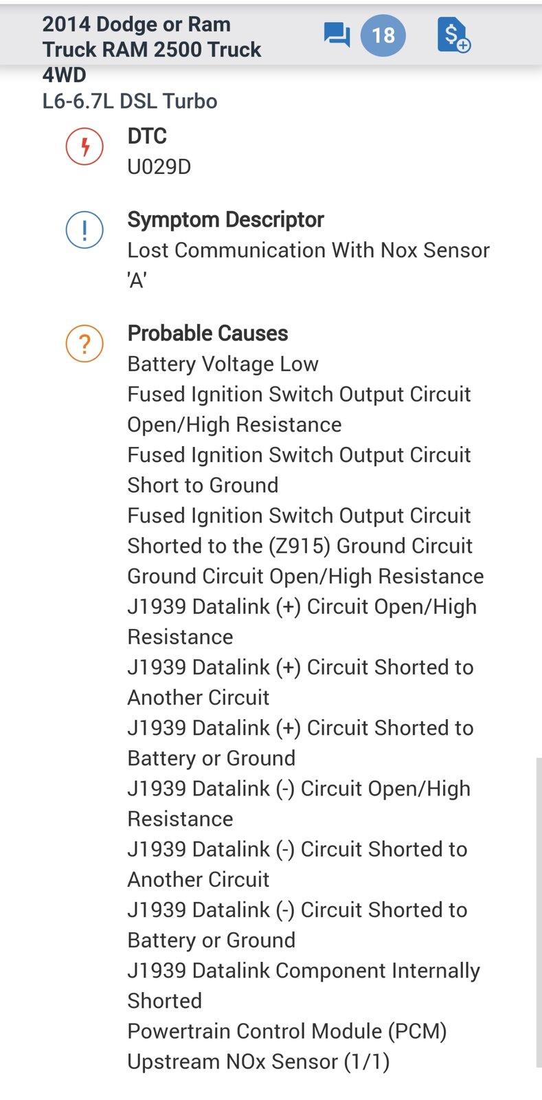

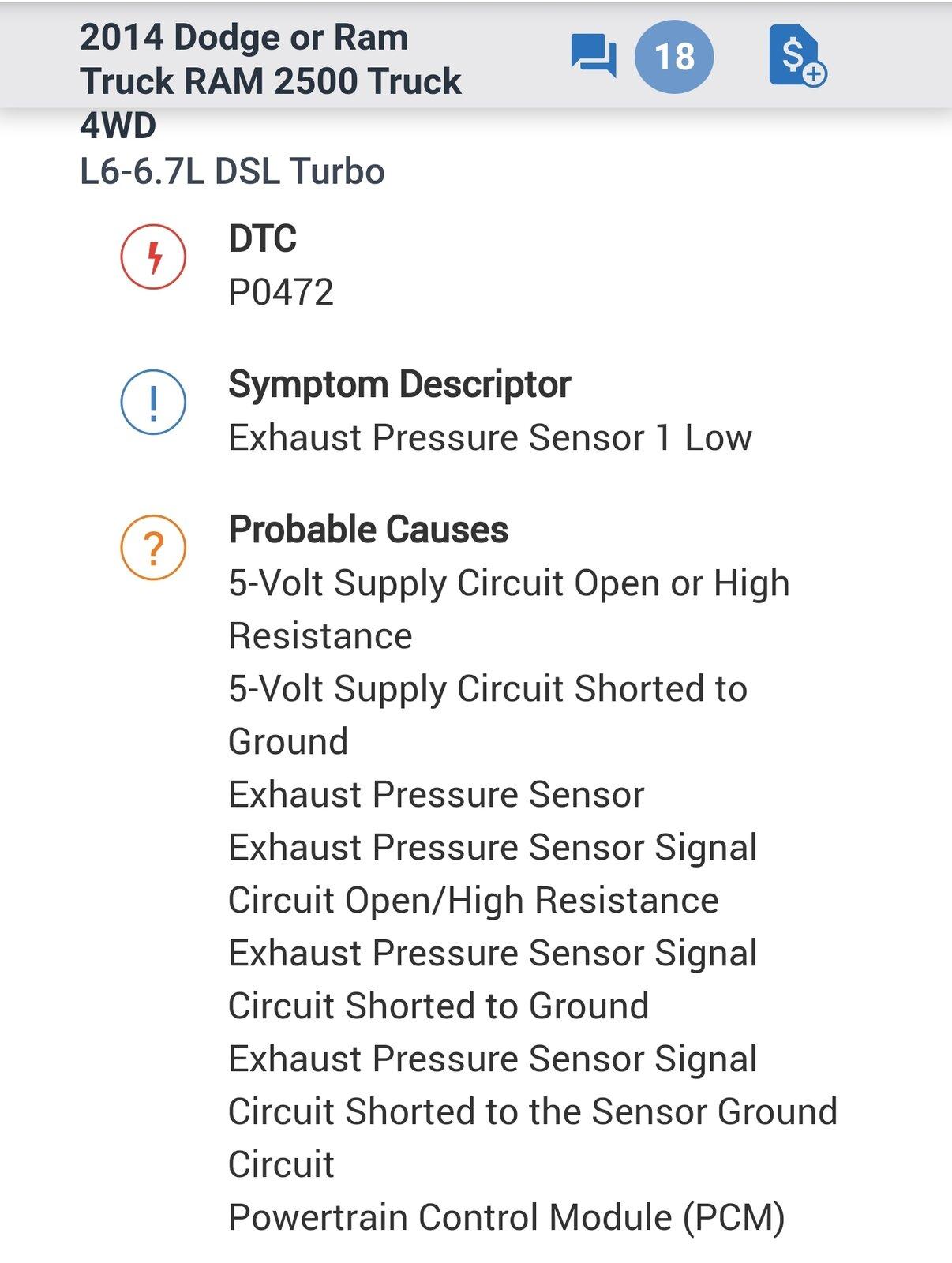

I would crawl under and look for unplugged connectors and see if they have dummy plugs in them.
Either way here is what I could find, just on that Code.
If they are pulling the sensors and possibly putting in some sort of jumper connector is it possible the wiring has an issue?
I really don't know what a Delete is or does, at a high level I understand it but my 96 is a Dinosaur.
Thanks for the information(images removed for the brevity of reply message). Are you reading these from a specific app? I have used a lot of error code apps and I like the way the information is presented in this one. I will take a look at all the plugs and electrical connections, etc.
