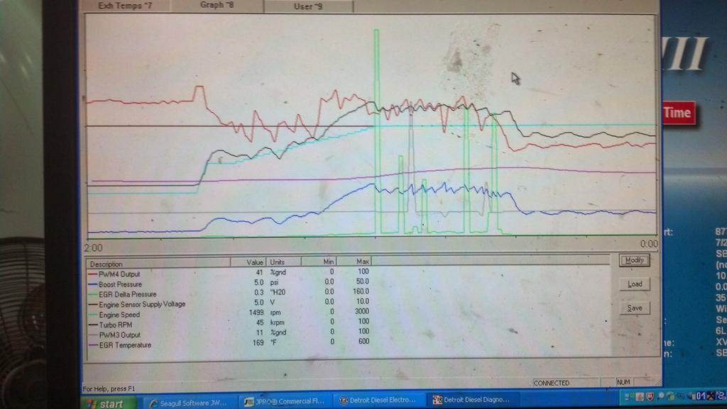

Also, look at the actuator/ vanes on the turbo, about 30% of the ones i've repaired had a worn out / sticking linkage / vanes in the turbo. if the turbo is fine, the Harness to the Vpod or the Vpod has been the culprit. I have screen shots on DDDL of one running right and one where the vpod/ computer cannot control the turbo due to wear in the turbo itself. a quick test is to slowly press your accelerator down and at a certain point, you can get it to surge ~ 32% pedal position or so..
This is the one of the bad turbo...
