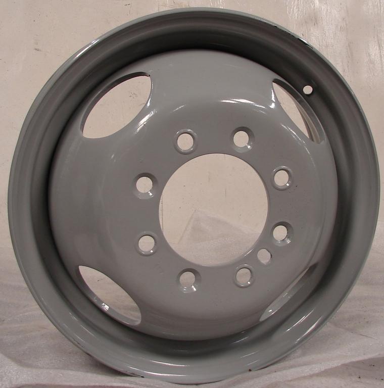

Just stumbled upon a great deal on these with brand new tires. My question is will I need new lug nuts as it appears these align on the studs vs hub centric?
Any thoughts or insight appreciated!
If they are like these wheels, then yes, you need coined lug nuts with a large hex. Also make sure the duals inner-face the tapered fit.

Yes, they are expensive but if you need the capacity they are the way to go. Commercial grade in the 16-18 ply range and as high as 6k weight rated each. I don't much care for that old style wheel thou, I doubt they are rated anywhere near what the tires are.

I used these wheels about 35 years ago on a motorhome dually axle. I aligned them with 4 of the 5/8 x 18 thread coned lug nuts and then installed the first 4 of the flanged lug nuts to 325 ft lb, then the other 4 flanged nuts. A hassle even if you have the lug nuts on hand.

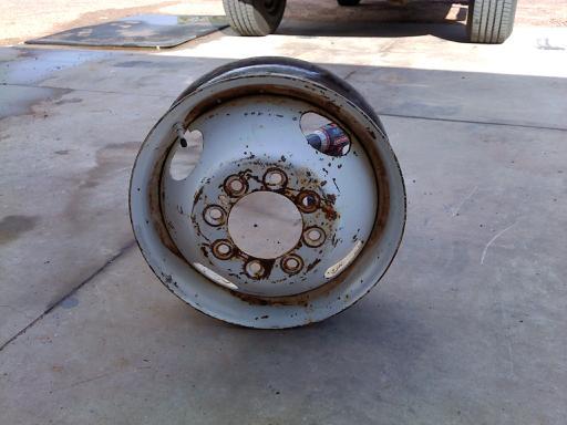

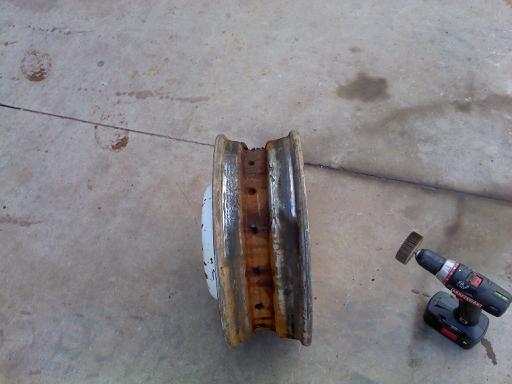

You can have it for free. I just dismounted the tire because I was worried the wheel might be rusty from laying outside flat for many years, here are some pic's. I think it is usable if it is cleaned up some or use a tube. If you have very far to drive it might not be worth it. The choice is yours, let me know.
