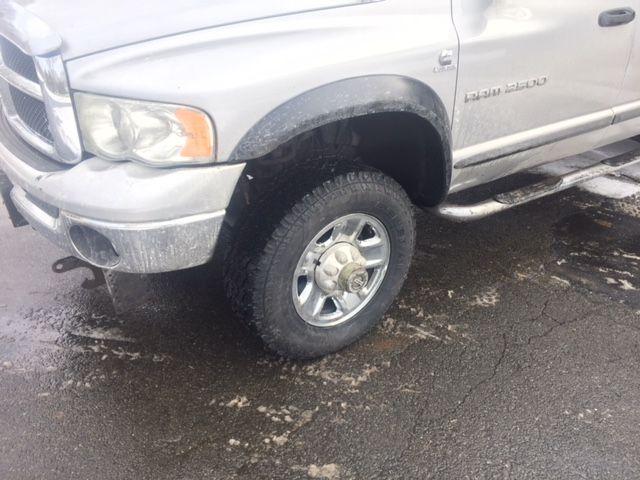

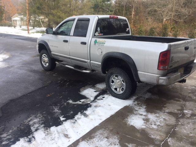

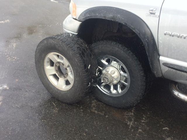

Just purchased a set of 18" wheels from a 2014 2500. They fit just fine on my 2003 SRW with Yukon free spin kit installed. Had to use my existing lug nuts and caps (the 2014 are metric).No machining here. Installed Lt 275/70 R 18 in General A2 tires. They look good and nice to have traction again! The old tire was a LT 285/70R/17 Cooper A3.

Yes the steel wheels will fit, but the aluminum ones won’t.

Thanks John! The one big reason I upgraded was the tire weight rating the 285/17" at 3195# and the 275/18" 3640#, thats a 445 #increase per tire! Just a little of added insurance! The only thing I would like to find is the proper Lug nuts that are wider at the end of the Lug so that I can use the 14' center caps. There is a small gap around where the old (03') center cap mounts to the wheel(maybe 1/8"). No big deal to me it's a work truck!, and a couple more snow runs and the polished wheel will be dull just like the center cap! - Thanks to Jersey road salt!!!! Also, the 275/18" tires where priced at $201.00 per tire and the 285/17" at $ 219.00 per tire a $18.00 savings per tire and added load capacity!!!Have your dad look at the General Grabber AT2, deep lugs and have a snow flake rating.
