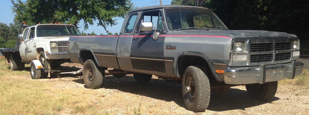

Hello all. I recently picked up my first Cummins truck. I have always been a fan of the Gen one trucks and of the simplicity of the 12 valve engines. I have several diesel machines around, Mitsubishi 3cyl powered Toro mower, Kubota 2cyl tractor, Yanmar 1cyl Generator, Yanmar 3cyl powered John Deere. But this is my first diesel truck... and I love it. Oh that sweet 12 valve music!
I'm not sure how many miles it has since the odometer stopped at 106k. The previous owner claims that it stopped working on him about 20K ago. I'm not so sure that is the complete truth. But the interior is in good shape, the engine is clean and when I picked it up it had no leaks.
The story of getting the truck is pretty entertaining. I had been looking for a crew cab truck out west that I could bring back home. Being from Kentucky, it is hard to find trucks of any vintage that are decent. Most are rust buckets. Just so happened, I found two trucks at the same time. One is an '84 C30 3+3 454 manual, the other is this Cummins. So I worked out a deal to fly into Dallas and pick up the C30 and drive it about 200 miles to where the W250 was located... then I loaded the C30 on a heavy duty car dolly and headed east for about 850 miles. Not sure if that decision was more brave or dumb. Regardless, I made it home almost completely without any issues. I did have to stop about half way home and unload/reload the C30 on the dolly. That truck is HEAVY and it was was only about 2 inches off center but it was really wearing hard on that sides dolly tire. Of course the rear drive shaft was unhooked so that was a hassle but I reloaded it and kept on trucking. Including picking up the dually truck I drove just over a 1000 miles in 25 hours. Averaged about 12mpg hauling 8000 pounds behind me running 65 with OD turned off the entire way. Man was I happy to get home.

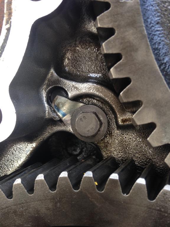

KDP - Figured while I have the front opened up I would check/fix the KDP, including new front crank seal and gear case cover gasket.

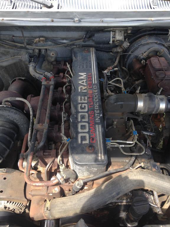

Engine - maybe nothing at least not for a while. It is stock with no pump tuning (which is unheard of) and it had no issues pulling the 8000 pounds from Dallas. I’m pulling a 4000 pound rock crawler on a 2000 pound trailer with a 1000 pound popup behind that.
