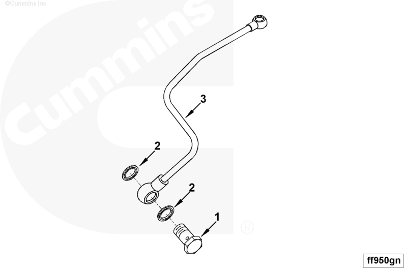

Since you said "filter to the pump" I'm going to guess you mean the injector pump. Part number for that line is 3936691. I would suggest new sealing washers, also. (2) 3918192 at the pump, (2) 3963983 at the filter.
Just a picture to go with, Item # 3.
Ordered the parts yesterday, got them this morning. Took about 30minutes to replace and that's with searching the manual for the torque specs on those banjo bolts. Thanks guys, really helped me out here.
