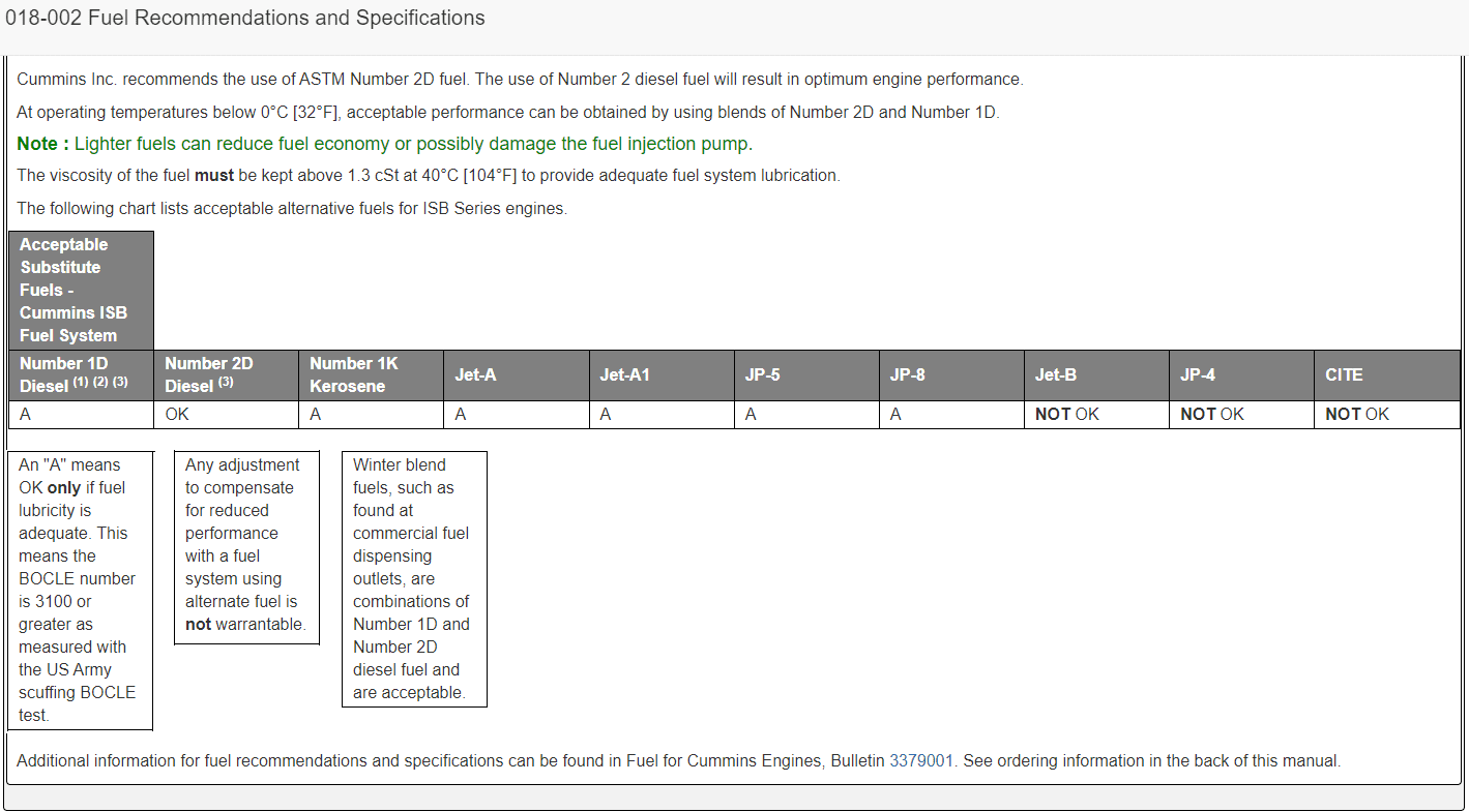

I found this. Still looking....
This came from the Cummins "B Automotive, Recreational Vehicle, and Bus Operation and Maintenance Manual" but it says "ISB". I know what you're talking about was on Fritz's Ram site, but of course it's no longer there...
