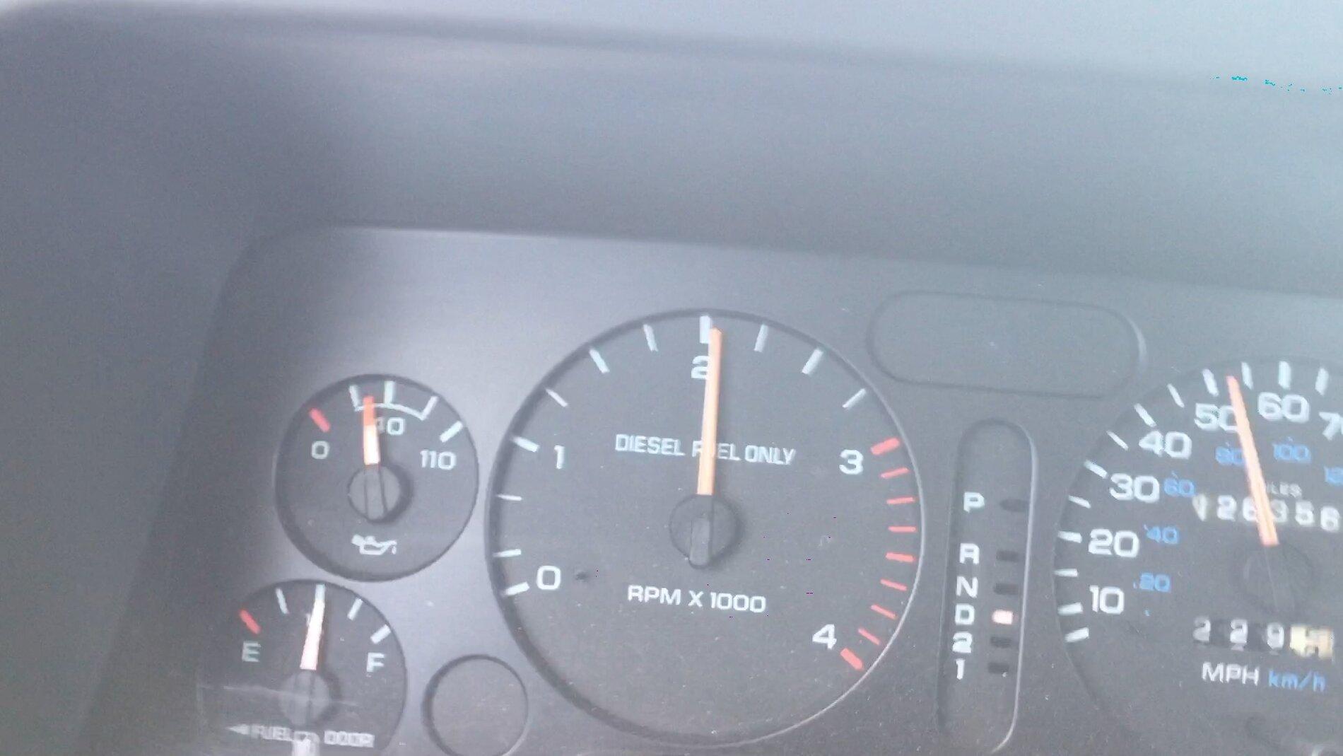

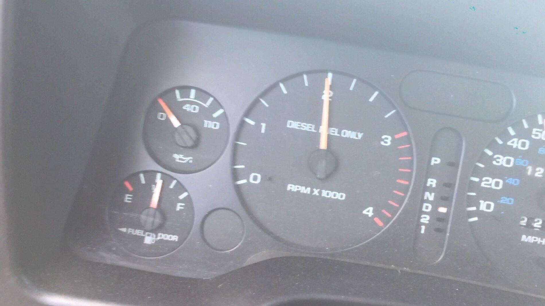

Arriving into Laramie, I started to loose oil pressure. Upon acceleration, oil pressure gauge would drop to 0, then rapidly build back up as transmission shifted to overdrive and I let off the throttle. This freaked me out. After camping one night, we got safely home by not accelerating very hard. Was able to maintain 40psi at cruise - 70mph all the way home by not applying too much throttle at once. I checked the sending unit per the 1996 Dodge shop manual. All OK. Ordered a pressure gauge from Genos. Now waiting. I plan to install it in the spare port next to the turbo oil line off the top of the oil filter housing. What in the heck would cause this?
Notice the low oil pressure warning light did not illuminate. I think it comes on below 10psi?
Once home, I dropped the trailer and unloaded. Oil pressure would only slightly drop on hard acceleration w/o the trailer. Why would a load cause the oil pressure to drop during harder acceleration?

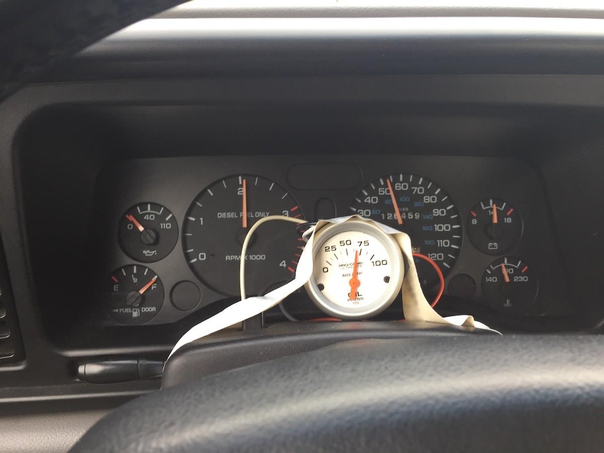

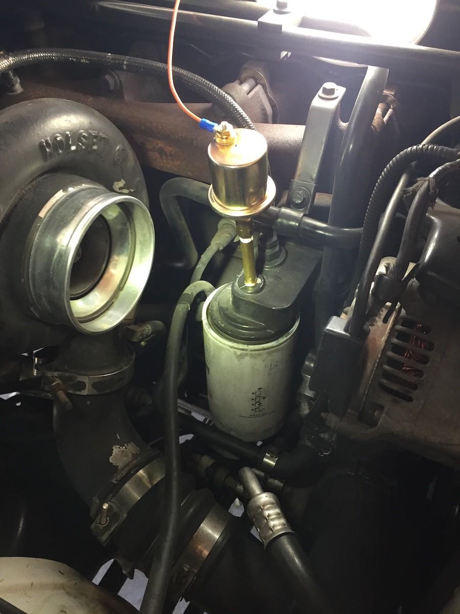

Thanks for the input. Installed the autometer from Genos. It is definitely the sensor. See install pictures.
Note the high tech white duct tape gauge installation. Have steering column gauge pod mount on back order from Genos.

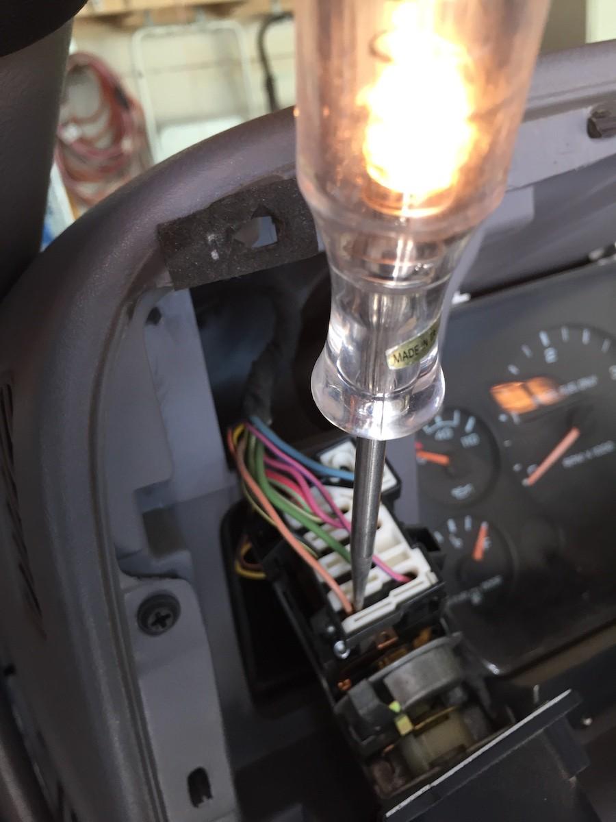

Note the tan/orange stripe dimmer wire on the headlamp pull switch. I did a search on this wire and did not find a good image so I am posting this one in case anyone in the future searches for dimmer circuit for gauge installation.

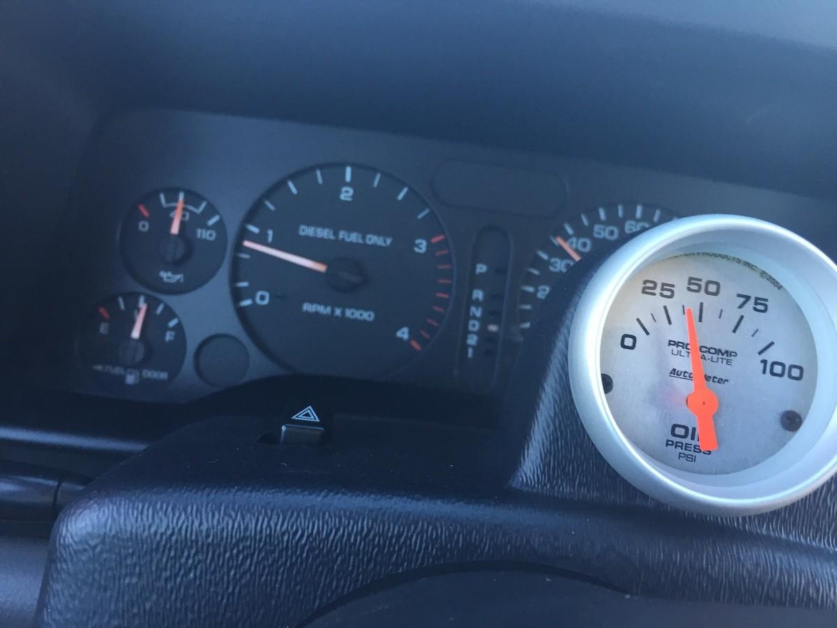

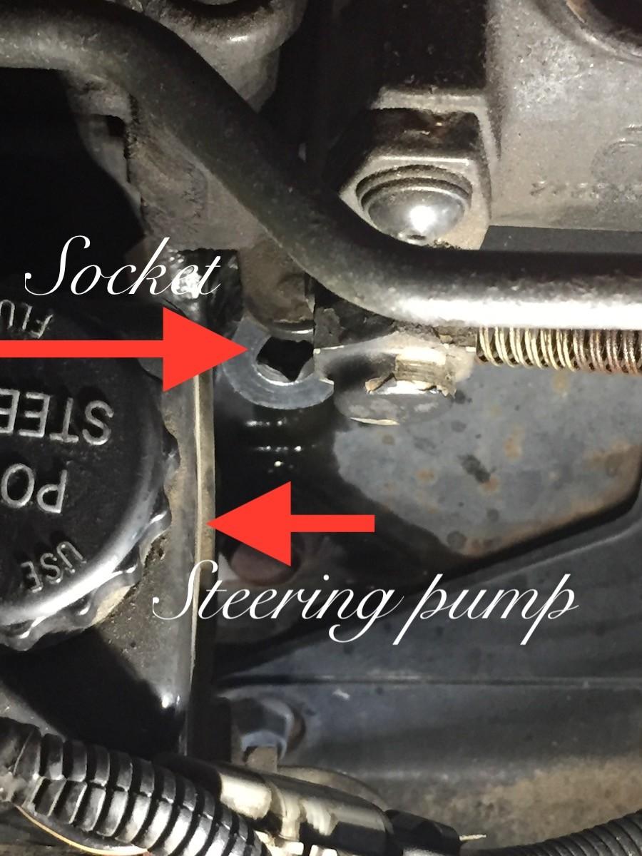

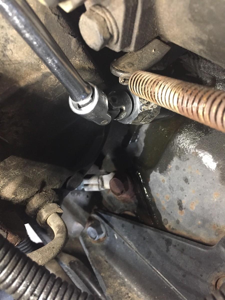

Good news! Oil sending unit fixed the problem. Now both gauges agree. Here are some installation notes.
1. Order the oil pressure removal deep thin walled socket!
2. Mine was very, very tight. Used a wiggler and 2 long 3/8's extensions with a 3/8 breaker to get loose.

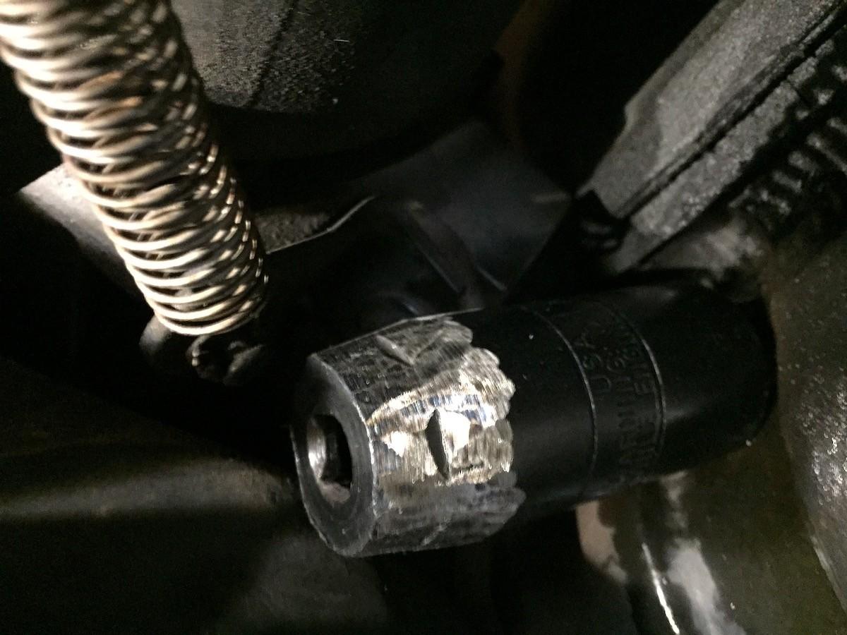

3. Socket would not fit completely over the sending unit. I had to grind the edges because it was hitting the steering pump.
