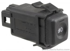

I was incorrect that there was a specific headlight w/ fog switch in 98. A little research revealed that the 98s were a transition year. Rockauto has the switches for $23.99. It is a small square switch that mounts somewhere in the dash. Maybe the emptyauxiliary power port. I don't know were it would attach to the harness. Rockauto also shows a fog light relay.
Picture from Rockauto:
i was under that is the switch for the 97 and earlier second gens that goes up by the cup holder/od switch??
On mine it's part of passenger airbag on/off switch. Mine did not come with fog lights so I got the switch from on that did. All the wiring is in place and by adding 2 relays in the underhood power dist. box,I found the harness with factory plug under the front of the truck on the radiator core support/frame. Don't forget(like I did) that that the harness will only power up with the head light switch pulled out to the parking lights or headlights on. I found the switch harness behind the center dash cup holder or dash pocket depending on a stick or auto transmission. I've seen the switch on ebay for a 97 truck
