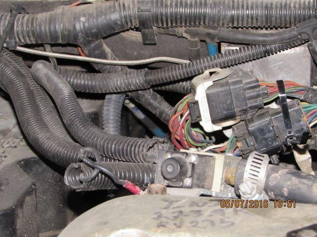

Also check all grounds. There is one next to the pass. side batt. that is often missed. Check the connector on the firewall that has a white bale on it. Mine was doing what yours is, after lots of different things I found that connection loose.
