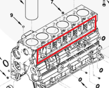

Definitely worth the upgrade. At the age/milage on the truck, the old tappet cover is likely bent/warped, and changing the gasket might get you a little time without a leak, but it will eventually start leaking again.ow finding quite a few articles and videos about people replacing Cummins stock sheet metal tappet covers with machined billet aluminum ones.
Do you guys think this is a good idea?
