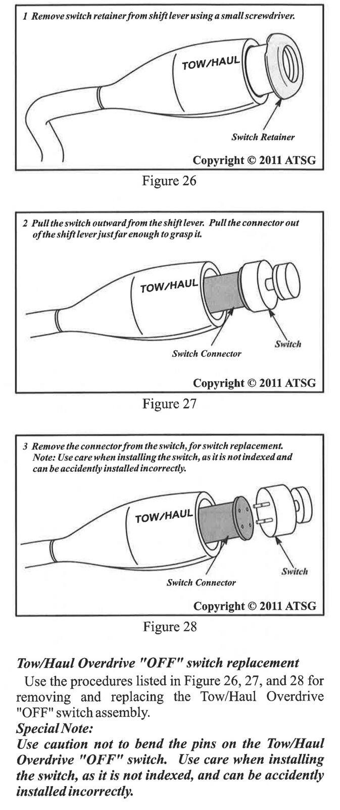

Found this on the Swich.
Ok . I figured it out called the guy I got it from and he said well I pulled a relay out of the spare hole and put it in the ac hole I wonder if the lid is labeled wrong well it must a Been swapped it and not it works . Now I have no od lockout going to test the switch it feels bad .
Should be able to check with an ohmmeter, should make contact of zero ohms in one direction and open in the other. Pretty easy for that one. Look at the actuator, I believe it's under the drivers side battery where acid and other things can not do it any good.
