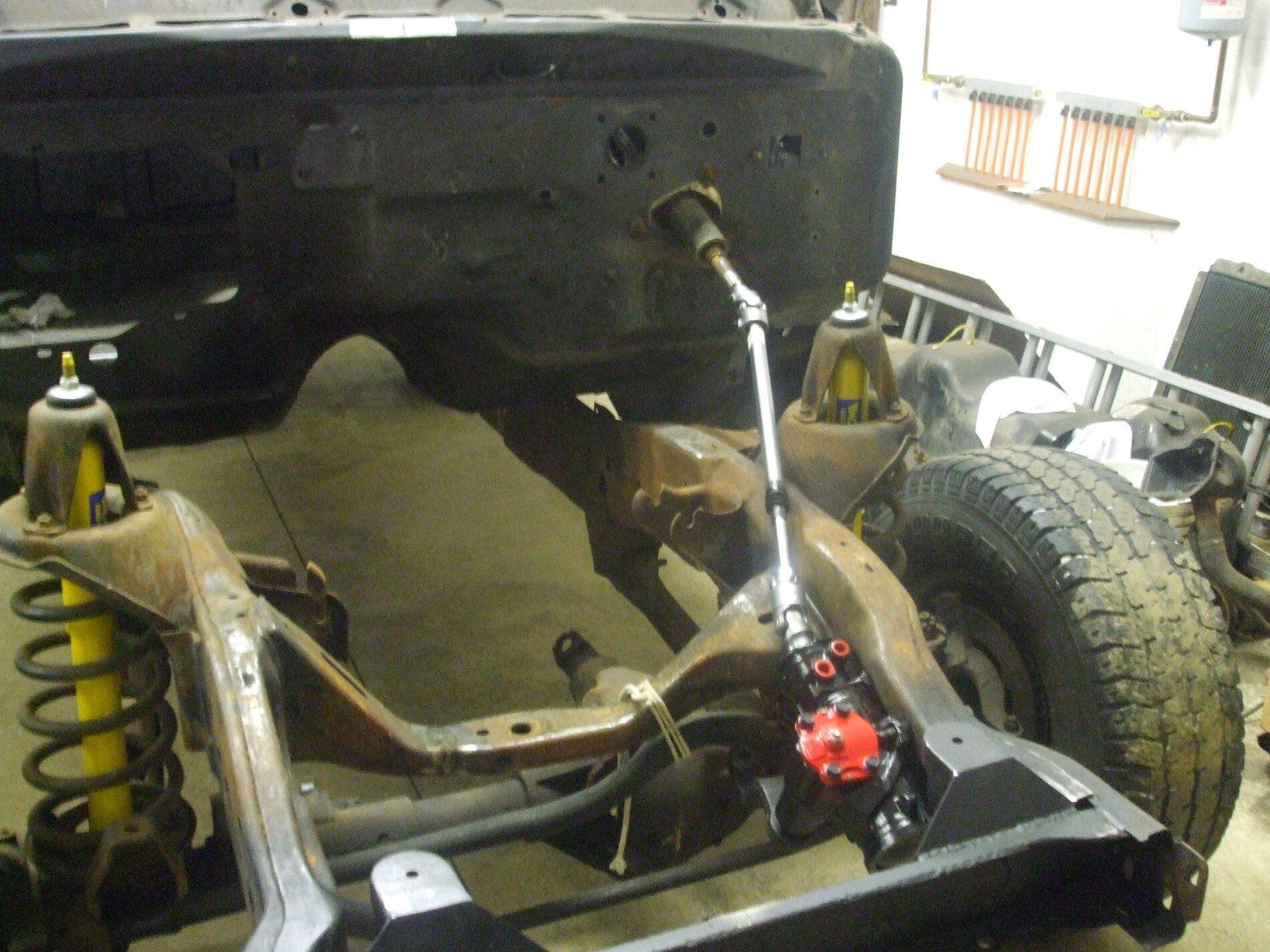

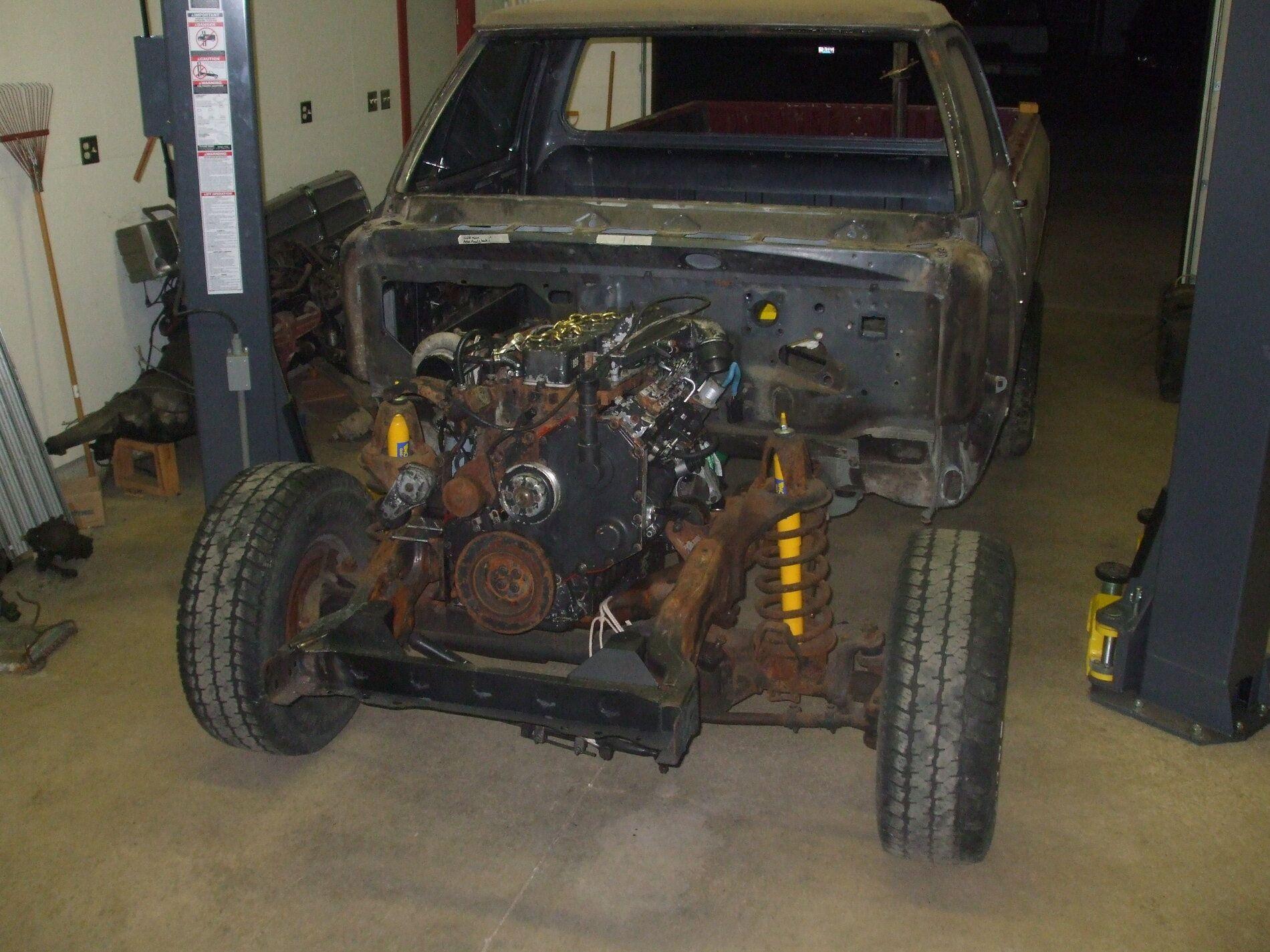

Currently building a 1st gen truck. I have a 1997 one ton 4wd frame to put 1st gen body onto. I have heard of this being done. Has anyone on here done this in the past? Just looking for some suggestions, tips, etc.

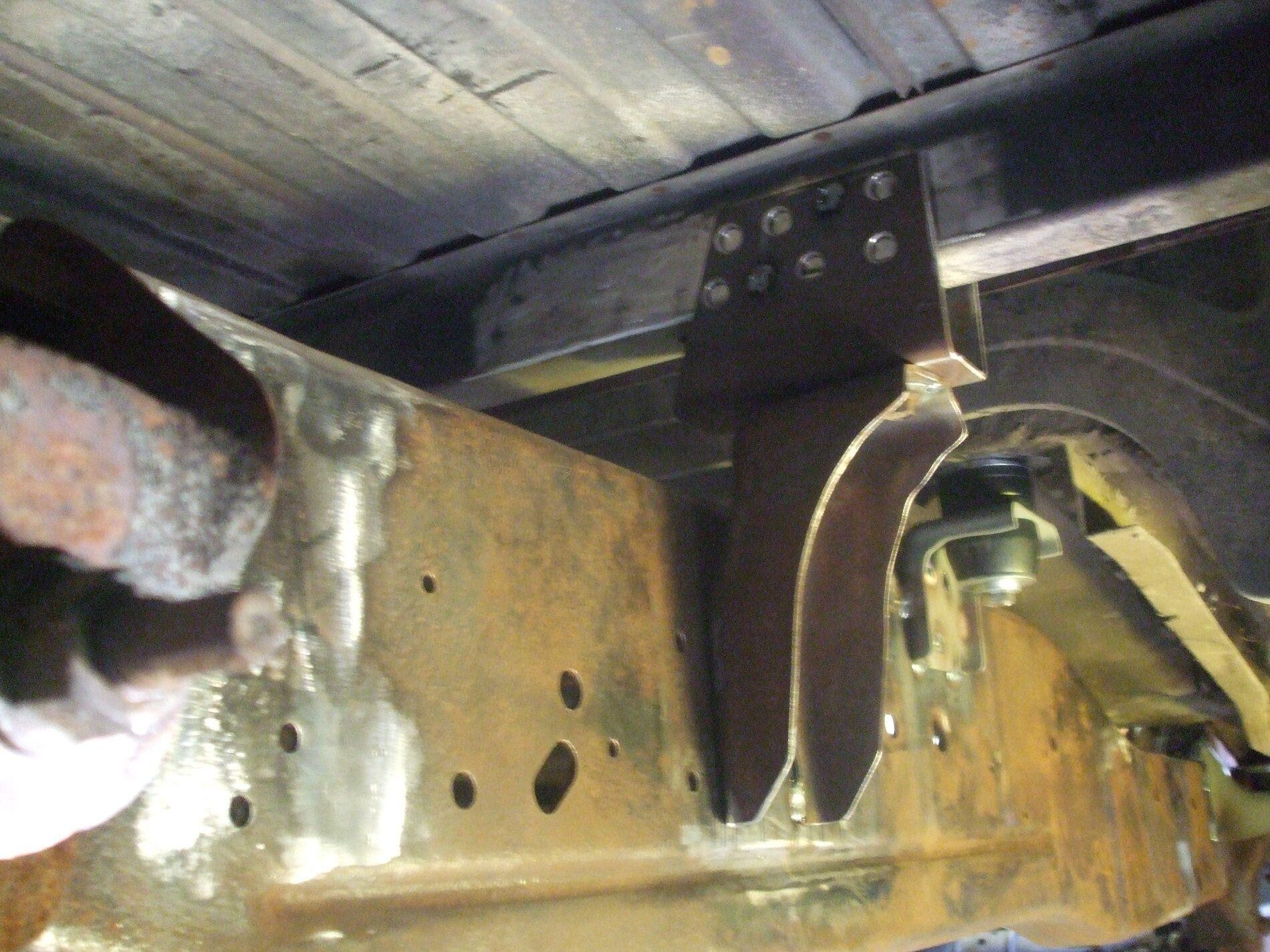

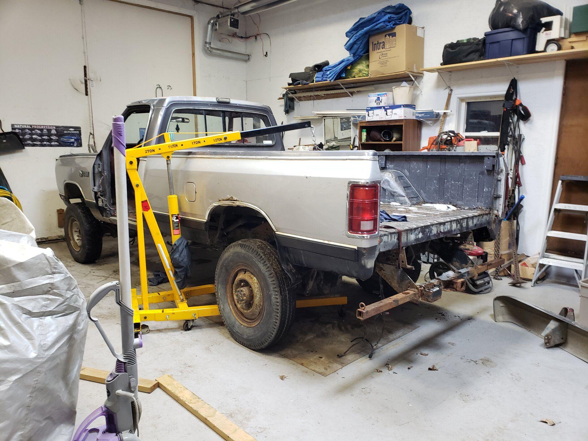

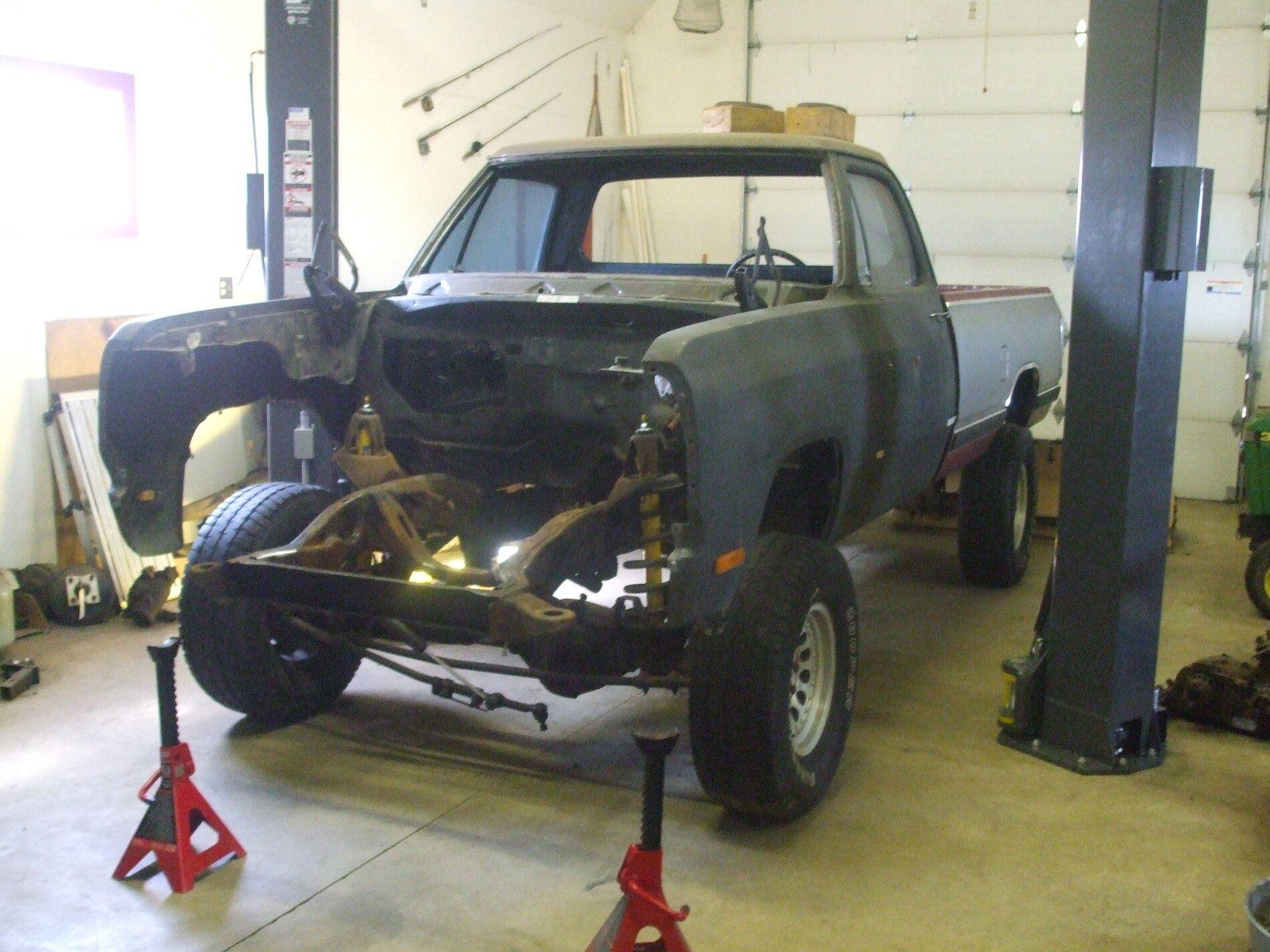

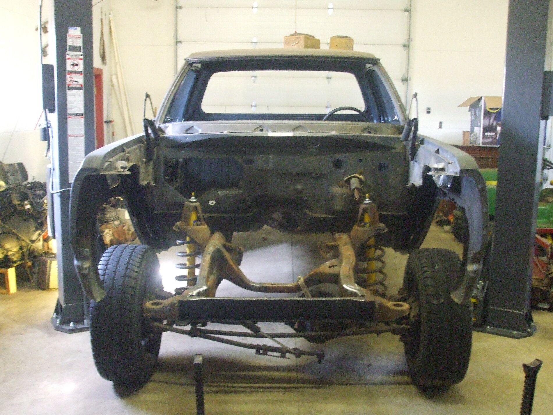

what steering shaft did you use there? im doing the same swap right now i just have the body sitting on the frame havent made the mounts yet.. but i need to rig up a steering shaft! also yours looks good so far how long have you been working on it? so far i cut a couple inches off the back of the frame havent done anything to the front but probably a few inches there aswell and might shimmy the rear axel a bit forward to get it closer to center of the wheel well
The steering shaft is Borgeson 2nd gen. The column is from an '85, cut the old rag joint off and made my own end to weld onto it. So the Borgeson shaft will slip onto it. Been working on this one for a year, got a lot to do yet. I cut the frame under the cab where the frame sections are welded together from the factory. Cut out 23 3/4" out and welded it back together. Didn't cut any of the frame in front or rear. Hope this helps.
You must have had an ext cab frame I got a reg cab and wheel base is 3 inch longer but frame also stick ms out past where the body is aswell
Nice.. Not sure how far you are on it but the two bed mount bolts closest to the tailgate dropped right into two holes in the frame. That put the wheel well centered over the wheel. But had to cut front bed mount brackets off the 2nd gen frame and move back about two inches.
