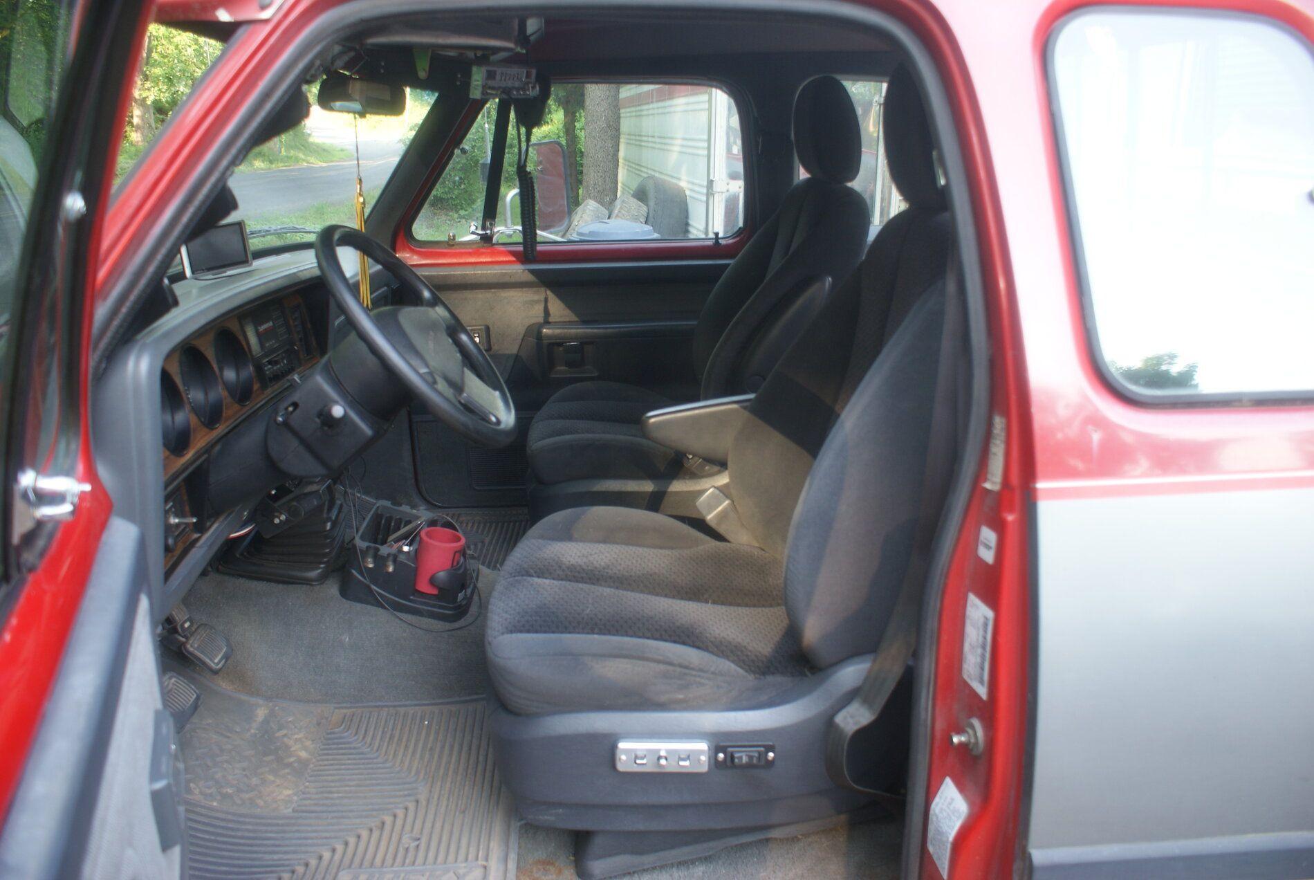

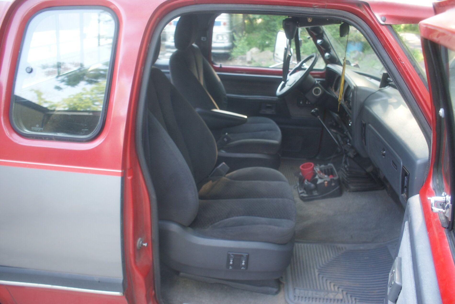

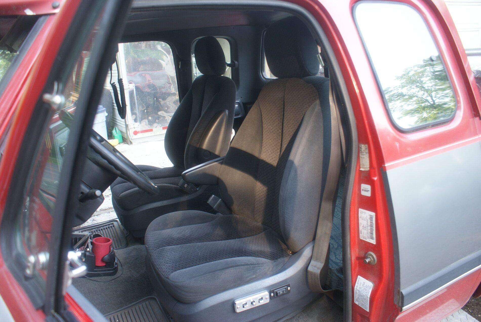

I cant help with that but i put seats from a 05 Chrysler Pacifica in my truck, you just need to take a weekend sit your new seats in there and put them where you want them and just keep working them until they sit level then bolt them down and add metal to the under side, I used 1/4" x 2" flat steel cause thats what i had. It just takes time and lots of small adjustments.
Those look great in your truck!
I cant help with that but i put seats from a 05 Chrysler Pacifica in my truck, you just need to take a weekend sit your new seats in there and put them where you want them and just keep working them until they sit level then bolt them down and add metal to the under side, I used 1/4" x 2" flat steel cause thats what i had. It just takes time and lots of small adjustments. View attachment 116535 View attachment 116533 View attachment 116534 View attachment 116535
