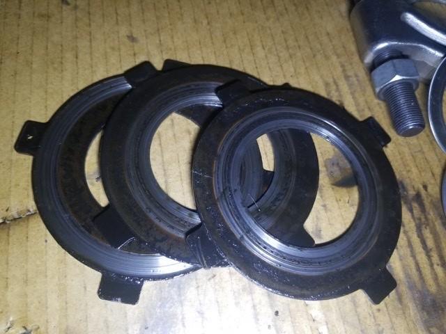

I was going through some slick areas today and noticed that one rear wheel was spinning faster than the other one. (1 barely and the other fast) I normally have posi-trac when going thru mud and such. With 295K, do I have a LSD problem, I just noticed this issue today.
Well Ozy, As bad as I hate to hear that, The old Red Mare has been very good to me for the last 20 yrs. and the more research I do, the more that sounds logical. I guess I'll start looking for a shop to take it to. Houston has some good shops.
It depends on the cost but you could consider a TrueTrac instead of rebuild the clutch style LSD. I don't know the price for the D80 but some Trues are in the 500$ range.
