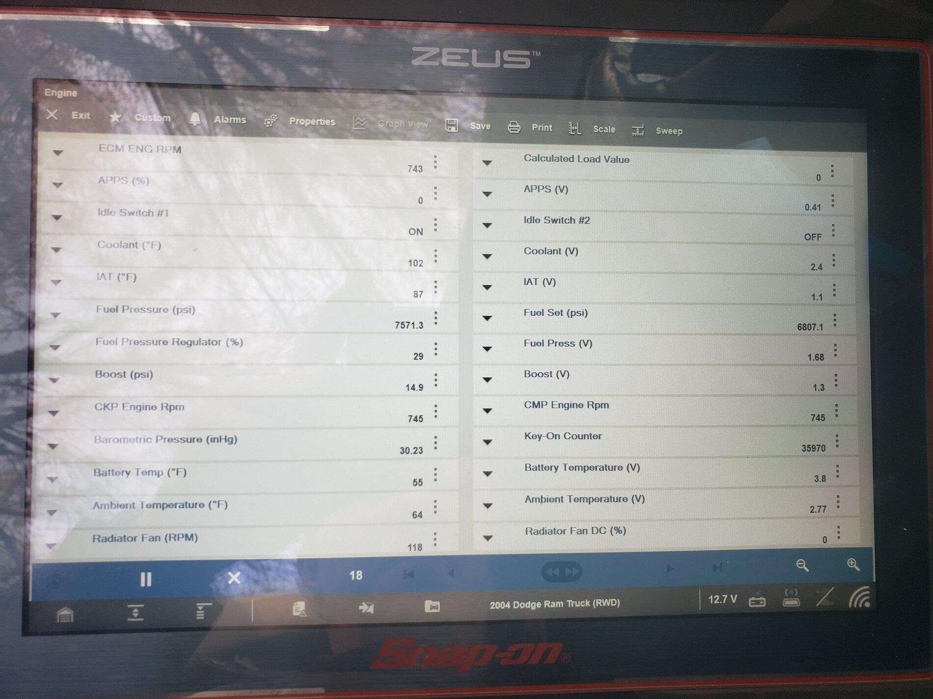

I recently purchased a 2004.5 Dodge Ram 2500 automatic transmission with a 5.9L Cummins diesel engine that starts right up (after I replaced the main battery cables (ground cables too) and a new battery). I'm guessing it has approx. 200K miles on it. Sometimes when you turn the key on, but the engine off, I hear a ticking noise (like a relay opening and closing) in the engine compartment for the first 45 seconds or so (I ignored it). The engine starts and idles normally, but if you accelerate the engine to 2,000 rpm or higher in neutral, the engine accelerates to 2,500 rpm and surges in between 2,500 and 2,700 and continues to do so. The engine does NOT decelerate when you let your foot off the throttle. After about 45 seconds, I give up and turn off the key and the engine stops normally. I replaced the fuel filter, swapped out the accelerator bell crank with associated throttle control sensor and the Fuel Control Actuator with OEM ones from a working truck. I'm new to diesel engines, but have been repairing gasoline engines for many years. On a gasoline engine, I would suspect the throttle control assembly, but that part does not exist on this engine. Could this be an ECU problem or a stuck open injector? It currently has a gasoline instrument panel, but I borrowed the correct diesel engine instrument panel and it acted the same way. The correct instrument panel is on the way. The scanner says the water in fuel sensor says 2.0 volts, but there is no visible water in the fuel filter container. Any suggestions will be greatly appreciated. There are no active vehicle codes on the scanner.

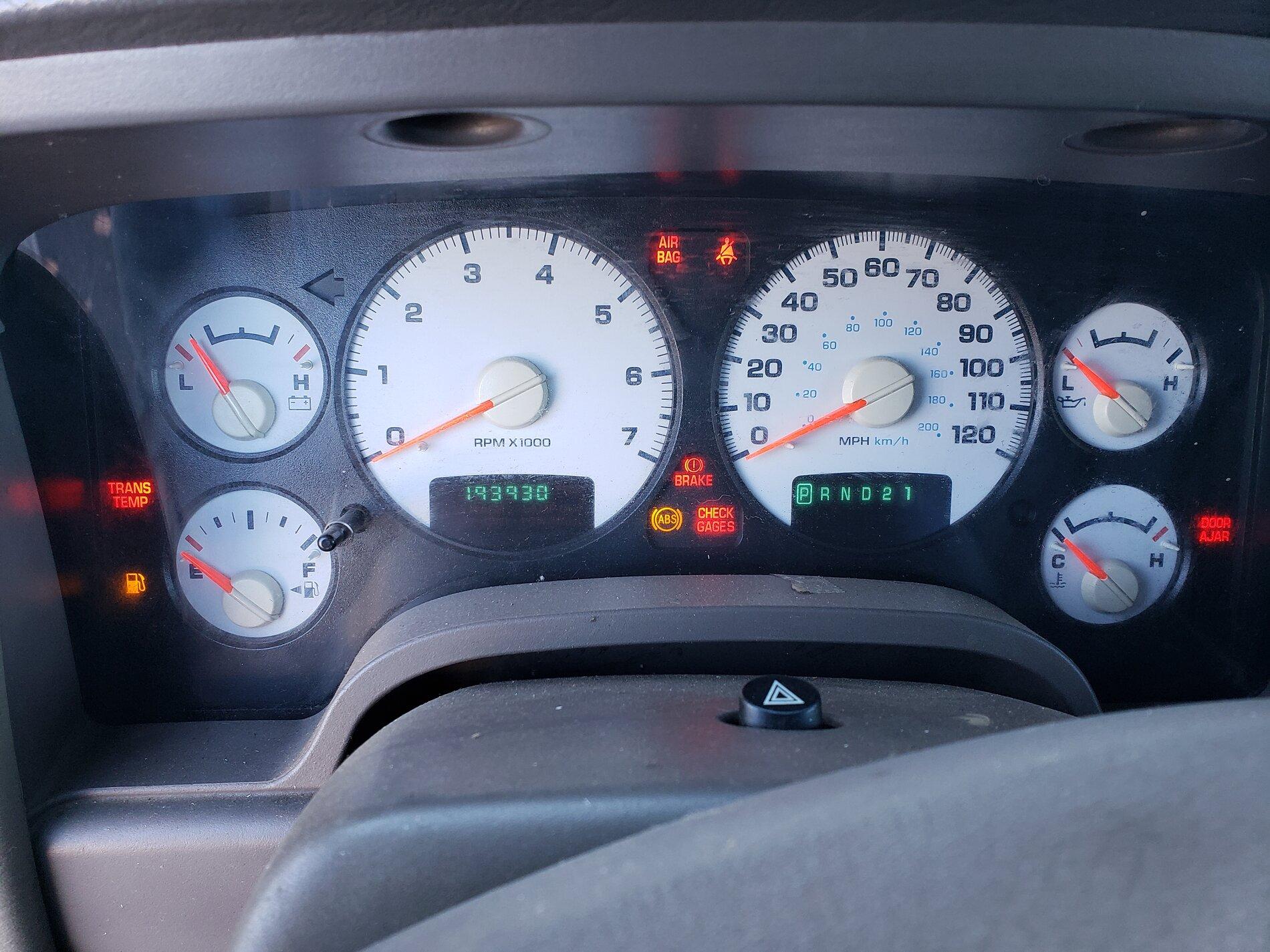

Why do you think the miles are approximate? I believe miles are stored outside of the instrument cluster.
Is the WIF light illuminated on the correct cluster?
Does it do the same thing while driving?
There is still a throttle position sensor.
I believe the mileage to be around 200K is because the instrument panel on the truck right now is from a gasoline powered Ram 2500 and everything is wrong. There is no water in fuel sensor light. Somebody replaced with the wrong one and the truck has a salvage title. I ordered the correct one from a junkyard, but it had over 450K miles and I was told it had 190K miles. I will order the correct one soon, but when I installed the correct instrument panel, the same exact thing happened. Once the engine accelerated over 2,000 rpm, it increased to 2500 to 2700 and surged AND did not come back down. DMV said the highest mileage was 160K on their history. 200K is just a guess. I called the dealer and asked how much they would charge me to tell me the accurate mileage. The answer was "we have no way of telling the actual mileage for any price". Apparently, their scanner (nor the one I used) has no way of interacting with the vehicle's computer to get the correct mileage.

The engine now has a P0251 Code. It says Injection Pump Fuel Metering - Control A (Cam/ Rotor/ Injector). I understand the common solution is to change out the Fuel Control Actuator (FCA). I have already done that. Could the Cascade valve (over pressure relief) be causing this problem?
