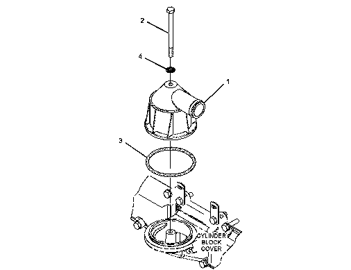

Ya, left side top near the final fuel filter upside down? I know the 3126 better, but if it's the same- HANDS OFF! I think that engine has liners. If it does, then it has a coolant filter. If not, it should.
I don't think this is part of the high pressure oil system. It has about a 1. 5" coolant type hose coming off it with a worm gear. And it's a black plastic housing. Surely this can't be an HPOP item.

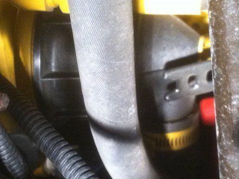

This round part is driver side (left) middle of block, midway between top and bottom of block. Has what appears to be one bolt holding it down... thru the center down to the yellow base it sits on I'd say. Like a filter housing. Probably has an oring around the base of it against the yellow base. There are no other spin on coolant filters anywhere. So I figured if there was one on here it might be inside this housing.
If there is no filter inside it... I guess its a "rotatable" elbow fitting that can go in multiple directions for different OEM's mabe. Just guessing.
This is the best pic I could get. This thing is back in there. If I do have to remove it... it'll be a challenge and require all of my long arms and mostly working by feel.

This is not bolted to the back of the front cover. The yellow base this black part sits on is bolted directly to the side of the block... perhaps tied into the cooling system.
By the same token I still am not certain coolant even goes thru this... I'm still guessing at this point.

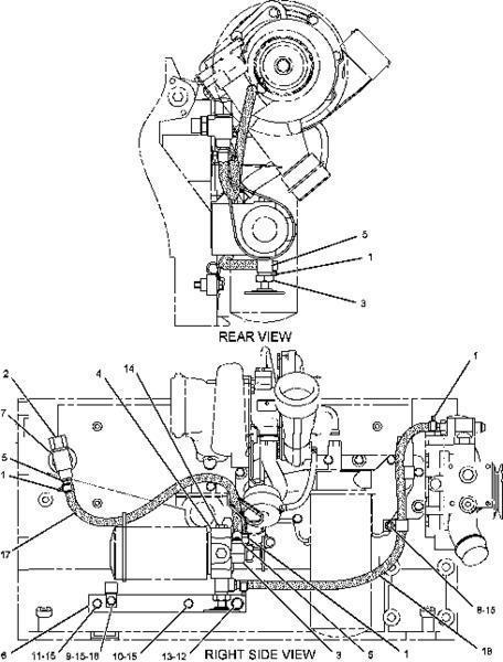

Try 123-0794 Coolant filter Gp.
I found this on an industrial 3126B with a serial # BEJ prefix. I believe the mounting and plumbing is the same.
Used a C7 in a Freightliner for this coolant filter group. It lays down as you can see. If you need them I can post part numbers to go with the illustration.
I don't believe I have a coolant filter. It's definately not as shown in the illustration. There are no external filters on this engine but for the fuel filter and oil filter. We've looked everywhere. But thanks for all the help guys!
