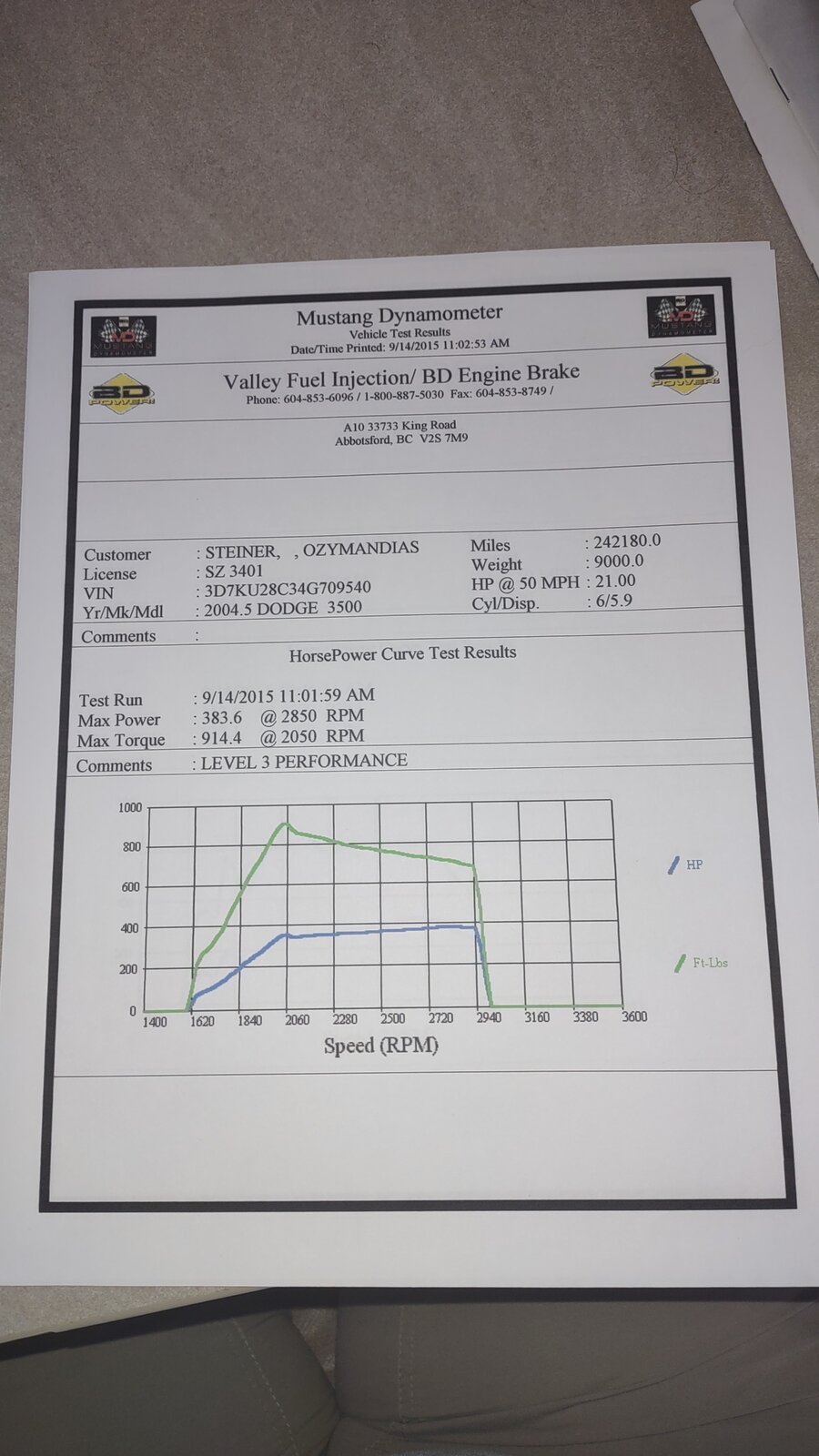

@AH64ID
I actually never played around with the SW's - I always used the 3 programs - Fuel safer, Towing and Performance with the default settings like they come from Smarty.
Should I play around for even better results??
Nice numbers, I wonder why the big difference in torque. That was also a lot later that I dyno'd mine, so maybe the software was updated. The default settings are fine, but I would play with timing for smoke and haze at elevation. If it runs good and doesn't smoke then it's probably set right.
