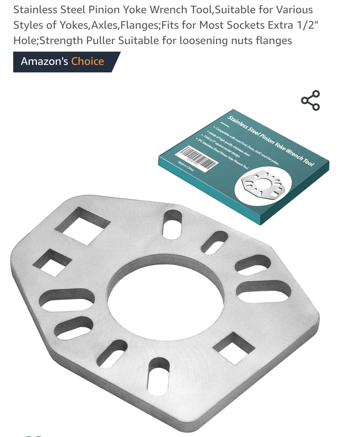

For folks playing along at home, I picked one of these up to hold the yoke of my little Dana 44, it was a fun project. Had to do all the set up stuff, rotating torque, Pinion depth, backlash, pattern, it was neat. Working with used bearings and ring and pinions are kinda of a compromise deal at times.
It's got alot of holes and should work for most yokes. Pretty heavy duty. The large square is 3/4" drive and the 2 smaller squares are 1/2" drive.

I would have an extra crush deal on hand, I'm sure I would screw it up. Mine used shims and was 220ft lbs for the pinion torque.
