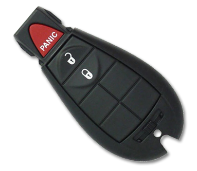

We have a 2008 dodge Caravan which has had quite the list of recalls and repairs in 80K miles. Not looking forward to a no start FOBIK issue.
Only have my experience and one other so far with a failing WIN but the common symptom of impending diaster is a no start. No click, no starter engagement, nothing. Then after a few more attempts the starter engages and off you go. In our case it was one no start in July, another the day before the WIN completely died.
Still asking questions regarding this type of failure.
Mike.
The SOB has done it again....
Went to start it for the wife yesterday morning ( 1 degree above zero) and the same crap as before. No start, no starter engagement, nothing.
If there had been a strike anywhere match in my hand it would have gone up in flames, I kid you not.
Waiting for my poor, overworked dealer to get it sucked back up on the rollback and get it to the shop again. They are swamped with cold weather issues and the rollback is on the road constantly right now.
They hope to fetch it tomorrow and get the same tech back on it Monday to see what has happened this time.
I assume that I got a junk WIN module.
Mike.
Wow sorry to hear that Mike. At least you have 2 stone cold reliable vehicles to fall back on in times like this. Will that module be under warranty?
If it works like my OEM then it will be covered if the WIN module has failed. Towing will not be covered.
If it is another issue than it will be on me.
Where STAR was only releasing them as needed that indicates that there is indeed an issue, there was also a core charge on the module that was obtained from another dealer for me.
That could mean that..
(1) The selling dealer had an old, non-current module in stock that was sold to my dealer
(2) The reman WIN modules are no good or have a high failure rate, possibly vendor issues........
If it is the WIN module again I am going to push for a new one. This has shattered my faith in both the '08 Van and the WIN / FOBIK system in general.
I will not buy another vehicle with that system if it can't be proven to me that the issue has been identified and solved.
Mike.
