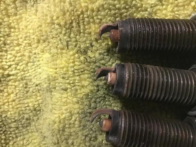

My daughter's 2011 JGC is showing a little misfire at low speeds. My scanner is showing a random misfire P0300 and P0306. I ran it thru town with the cylinder data showing and #3 and #6 were misfiring. I'm going to pull it in the garage tonight and do a leakdown and compression test and if those are good, throw a set of coils and plugs at it. Unfortunately I found a TSB from 2011 describing a check engine light caused by head problems.......I hope thats not the case. Jeep has 124k on the clock.

I bet on the plugs, the change interval is way to far stretched from the factory.
Had the same experience with my HEMI when i bought it used with like 50K miles, plugs worn but interval is 100K miles.
Near zero leakdown. Plugs were pretty bad.
As bad as those plugs looked I am sure you did the fix. Wish the Wife's Toy was that easy. To get to the rear plugs on that stupid sideways engine yo have to disassemble the top of the engine and that"s after you remove the wipers, cowl panel and wiper motor. What a PIA.
Yes, plugs were the originals. 124k miles. I installed new coils and new Champion plugs (factory gapped but I checked them). Instantaneous improvement in idle quality and after a 40 mile test drive I can say it’s fixed. It is a smooth engine and all cylinders are firing normally with no more misfires.
