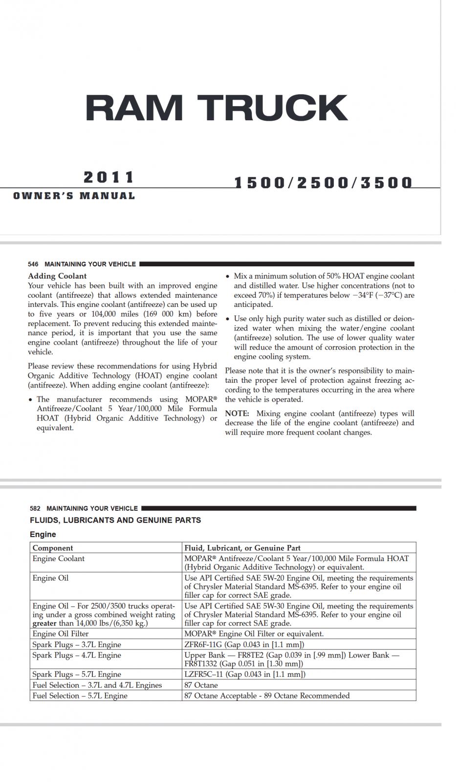

Just wanted to get confirmation on the correct coolant for a 2011 Ram 2500 (What is out thee is a little confusing). Is it correct that it is the HOAT coolant?
68048953AC is what the online parts stores are indicating, but the owners manual seems vague. This is my old truck that I gave to my father and trying to figure this out remotely is challenging.
