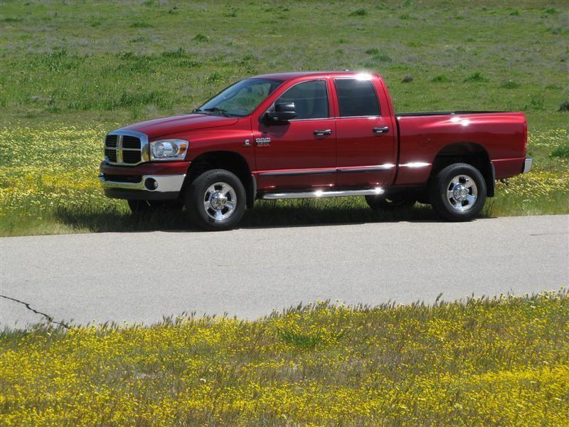

I am going to have a set of POLISHED Factory ALUMINUM wheels with original tires for sale soon from my 2007. I ran them 35,000 mi then took them off and inside stored them. NO scratches or nicks have the lug nuts, two factory chrome SOLID hubcaps and TWO chrome factory caps that I put a center hole in for the free spin hubs. PM me if anyone is interested as they will be in the classifieds soon.
Motorhead
Wow she sure is pretty. I have the same color, sometimes forget what it looks like under all the mud!
