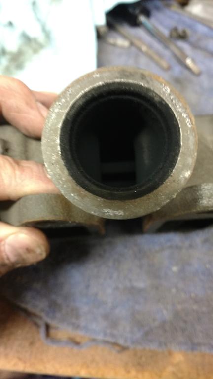

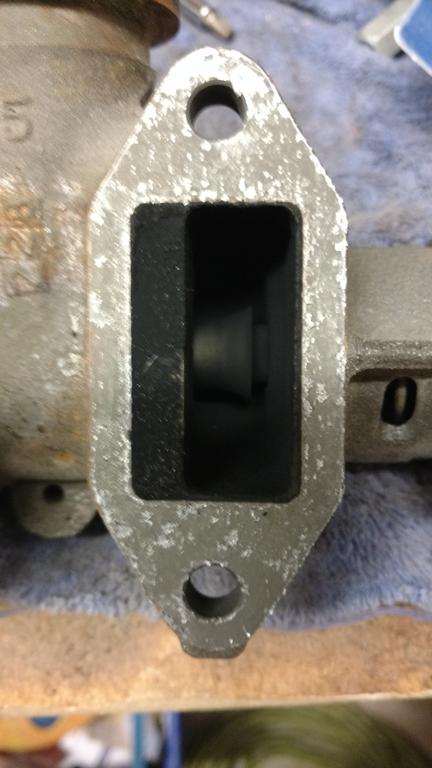

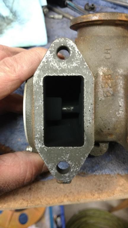

Truck runs fine after I cleaned the EGR valve. The cooler cleaning was a "well, may as well" service since I did the EGR valve.
post up some pics of the guts of your cooler when you clean it. other than cost, I can't imagine you'll cause any more issues (not being facetious, just my humble opinion!)
